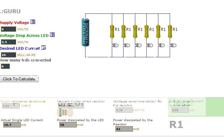

I researched the LEDs and I came up with these two wiring diagrams. (which way do you think I should wire up my LEDs, #1 or #2?) I plan on connecting it to my 6 volt power regulator.
#1 Is of a parallel wiring diagram
#2 Is the websites "GURU" recommended wiring diagram
« Last Edit: May 14, 2012, 07:35:03 pm by mpick67 » Logged

HI,
Circuit number two with an individual resistor for each led.
An even better option is to connect parallel sets of two or three LEDs in series. You still need a current limiting resistor for each parallel set but it's more efficient.
Are the LEDs going to be on all the time or will they be controller by the Arduino ? If you want to control them you might need additional components.

These 6 LED's will be controlled by the Arduino UNO. I want them to turn on when the servo is at 0 degrees, and turn off when the servos moves to 180 degrees. Any ideas on the additional component's that I'll need to achieve this?

   To drive six LEDs from a single pin, you have lots of options. I usually use a standalone (DIY) Arduino for this interfacing with my RC Cars in which case I have access to the LIPO voltage before and after the regulator, if I was going to drive six LEDs from a single pin I would connect two parallel sets of three series LEDs, these would be connected to the unregulated 8.4 volts from the lipo through a current limiting resistor (one for each paralllel set of three series resistors) and then through an npn transistor to ground. The Arduino would drive the NPN transistor which would effectively be acting as a switch to turn the LEDs on and off.
The good news for you is that your Arduino UNO also gives access to the unregulated 8.4 volts through the vin pin. If each LED has a voltage drop of around 2 volts, you can connect three in series, two sets of these gives you your six volts.
Rather than me try and explain this, have a look at this link -
http://led.linear1.org/led.wiz
put in the following values and see circuit 2
8.4
2
15
6
Your LED voltage drop (value 2) is probably going to be different, I will leave it to you to figure out where or how to find this out.
