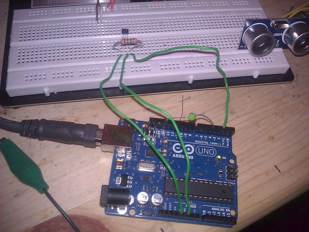

I didn't do much but I am getting serial output of RPM to the serial monitor and I'm getting a single LED to turn ON/OFF with RPM changes. My RPM measurement doesn't seem to be accurate but it is proportional so I figure I can tinker with the code to get it working. I guess the numbers really don't matter as long as I can get the output to register correctly. I'm not going to be using the serial data anyway.
I did get the hall effect sensor working after learning that I needed a resistor between the pos and signal  :smiley-roll-sweat:
Just one sad little LED for output but it's a start:
No little magnets to mount on my test rig so I'm stuck waving a big one over the HE sensor for now... I considered using a PC fan 3rd wire for input but I want to stick with what I'm going to use in the final build so I don't complicate things.
