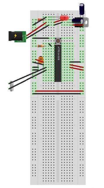

Hello,
I recently assembled an 'Arduino on a breadboard' as outlined on one of the pages on the Arduino website. However, I kept getting errors when I tried to upload any sketch. After much searching on these forums, I found that the answer was to hit the physical reset button shortly after you hit the Upload button in the Arduino IDE.
I was just wondering why this is, because you don't have to do that when using the store-bought Arduino boards. Is there something I can do to make it so that I don't have to remember to hit the reset button each time I upload a sketch? Not that this is a huge deal, but it would be nice if I didn't have to. It must be a piece of hardware (electrical component) I'm missing?
Aside from the Breakout Board for FT232RL USB to Serial  - http://www.sparkfun.com/products/718, here's my circuit:
Thanks,
Jamie

A 100nF capacitor can be used as shown in the schematic below to create an auto-reset circuit.

See this page:
http://www.gammon.com.au/forum/?id=11637
If you have a 0.1 uF capacitor in series with the RTS line, you shouldn't need the reset button. Halfway down that page I uploaded a sketch without having to press a reset button (I didn't have one).

In order for the Arduino to be able to accept the new sketch it has to be running the bootloader.
The bootloader is the first bit of code the Arduino runs after a reboot or power-up.  After a short timeout, if no sketch has been received, the bootloader exits and runs the currently loaded sketch.
Normally the Arduino performs a reset whenever the serial port is opened by the computer.  This is both annoying and convenient.  Convenient in that when you go to upload a sketch the Arduino reboots and enters the bootloader automatically.  Annoying because when you connect your running Arduino to a computer and open the serial port it reboots it, losing any data in the RAM.
So adding the capacitor as mentioned will enable the auto-reboot - it will also enable the wipe-your-Arduino's-RAM function on opening the serial port.

Put a pull-up resistor on Rx (D0 or pin 2 on the chip).

10K (the exact value doesn't matter much) between the pin and +5V. That is a "pull-up" because it weakly pulls the pin "up" to 5V. A "pull-down" would be tied between the pin and Gnd.
The reason for 10K (rather than, say 10 ohms) is the current it would draw if the pin happened to be configured as an output and set low.
Using Ohm's Law, I = E/R the current would be 5 / 10000 which is 0.5 mA. However if you used 10 ohms it would be 5/10, which is half an amp (which the pin can't handle).
So, since it is 0.5 mA the wattage will be low (5 * 0.5 mA = 2.5 mW) and thus a 1/4 W resistor (250 mW) would be plenty.
The reason for it is, without it the line (Rx) will probably have noise on it, and the bootloader will take a few seconds trying to make sense of the noise before it gives up.
