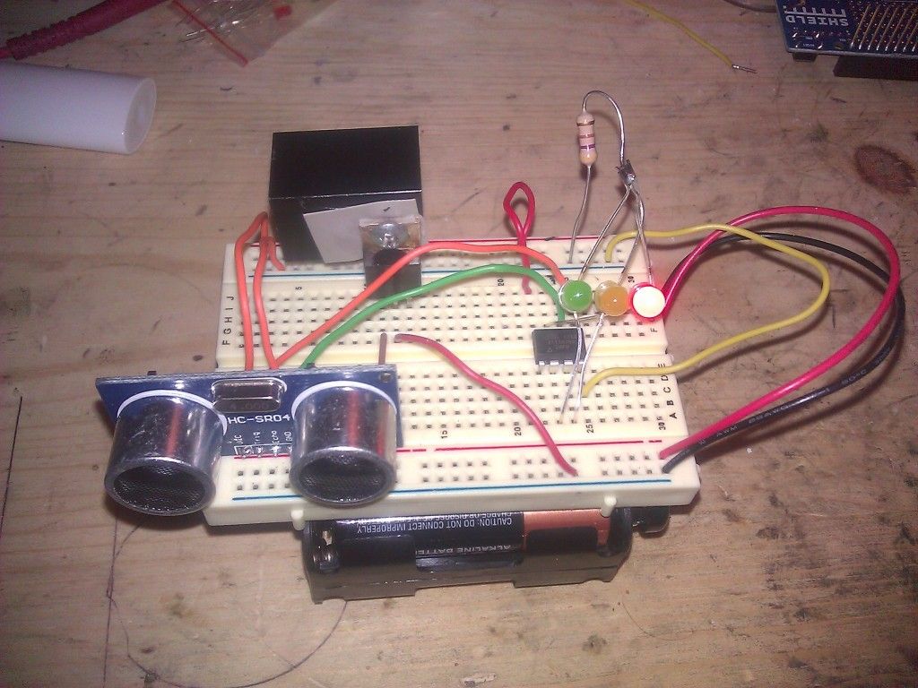

Here's a sketch that works with the 85 and an Sr04 sensor:

It uses all of the 85's pins and it's a little wonky but it's close.  All it does is light 3 LEDs based on distance from the sensor. I think the code is screwy but the hardware seems to be doing it's part!
Look ma, no Arduino:

Excellent!  Congratulations!
I picked up a proto shield and some odds and ends from RS and I'm thinking about making a dedicated 85 programmer. Any input on this?
Include 220 ohm (or higher; 1K is typically used) series resistors on MISO, MOSI, and SCK.  A problem like this one could create a short-circuit through the two processors and damage them.  The resistors keep the current flow in a safe range, they are dirt cheap (compared to everything else involved), and they cause no problems when programming.

Thanks again!  I'll be sure to include the resistors. Have to check the pinout...
Just to clarify, I'll be placing the resistors between the Arduino pins and the 85? In place of the jumper wires?
I have a big resistor assortment that should come in handy!
