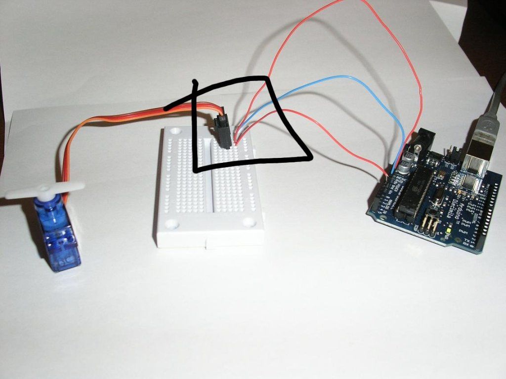

I am very new at Arduino (I just got started yesterday). I have the Uno, Motor Shield r3, and 2 standard Servos that I bought at Radio Shack:
I want to know how to hook the servos up to the motor shield or uno. There are very little tutorials with the depth I would like for some reason.
Thanks!
marco_c
You don't need a motor shield for a servo, but you do need a seperate power supply for the servo as the Uno can't provide enough power for itself and the servo.
Servo will have 3 wires - +V, Gnd and a signal. The signal needs to be pulsed to move the servo, with specific timing. There is a Servo library that does this work for you as part of the Arduino IDE install, and there is information in the Playground on how servos work.

SamKirkiles
Thanks a lot for your help!
I have 2 questions though. What is this and where can I buy it?
And what is the advantage of having the Arduino Duemilanove rather than the Uno?
marco_c
Looks like the bit you highlighted was the plug? No idea where you get one, but I would just poke some wire into the servo socket and use that if you are building a temporary circuit to test your ideas.
The white thing is a breadboard and you can get those in any elecronics store, ebay, etc.
Duemilanove (2009 in Italian) is for this purpose no different to the Uno. I think it is just a 'older' model with a different CPU.

DuaneB
And because in the picture you are not using separate power, please have a look at the two links in my signature for an illustration and solution of the next problem you will have.
Duane B
Read this
http://rcarduino.blogspot.com/2012/04/servo-problems-with-arduino-part-1.html
then watch this
http://rcarduino.blogspot.com/2012/04/servo-problems-part-2-demonstration.html
