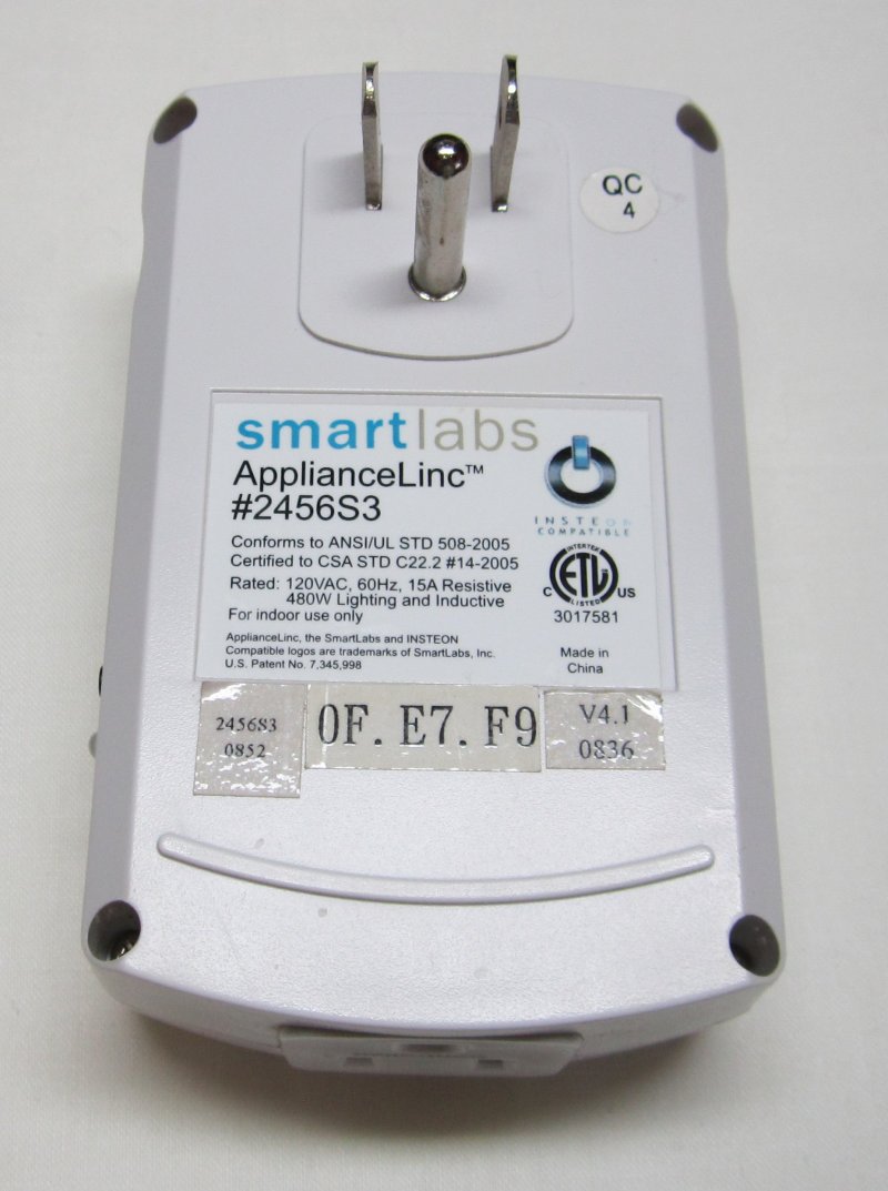

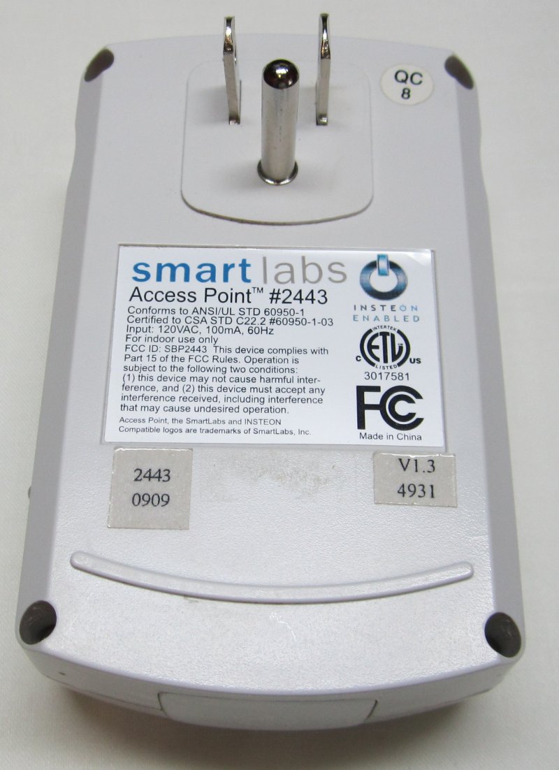

Well after almost 2 years, I've found the problem of my issue!
The culprit(s)?:
and/or
(These are a couple Insteon smarthome Devices)
I don't know why I didn't think to try it sooner, but a few months ago, I just decided to pull the above 2 devices (sorry I don't know which one of the 2 is actually the cause of the problem, but once I do, I'll try to report back if anyone is interested) out of commission in my garage to see if anything improved. Sure enough, I had no problems with it after I removed them.
I created a post on my blog that talks about this a little more, but that was it! I just thought that everyone who helped me out with this deserves to know, and anyone who may have the same 'setup' as me may benefit from knowing this too.
Thank you very much to all who generously helped me out in troubleshooting this long-standing problem!
