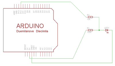

Got myself a new pack of resistors and managed to mock-up the circuit without further damaging my eyesight.
Rather than create a new thread, I was hoping someone reading this wouldn't mind confirming if this is safe for the Arduino.
Basically, I want
  • Arduino digi pin 12 to be "disconnected" (or whatever the term is for the not-high-not-low state); this means that 5v flows through the 100k resistor to the LED and it's a bit dim.
  • Then, when the Arduino decides, it can send pin 12 high and give the LED a boost by applying voltage through the 10k resistor to a bright state (although not corrective eye surgery bright). I worked out that 10k and 100k resistors in parallel end up giving me about 10k resistance in total.
The bit that concerns me is switching the pinMode of digi 12 so frequently. Is this likely to cause problems?
Here's the circuit and a bit of test code (it all works).
Code:
  pinMode(_LEDBOOST, INPUT);
  delay(5000);
  pinMode(_LEDBOOST, OUTPUT);
  digitalWrite(_LEDBOOST, HIGH);
  delay(5000);

Instead of that 100k ohm path to keep the led on dim you might just want to see if turning on the digital pin's pull up resistor might work. That would save you a resistor and some wiring.
Code:
  digitalWrite(_LEDBOOST, HIGH);  // this will power the led with the
                            // internal pull-up resistor at around 40k-50k ohms
  delay(5000);
  delay(5000);

Hi Lefty,
Unfortunately, the supply line running through the 100k resistor is kinda part of an existing circuit that needs to stay. (Although I think it currently only has about 120R in there so I'm ramping it up). Essentially, I'm changing a red LED in a power-on/reset circuit, to a high power blue one and wacking in an extra feed to boost the LED luminosity when the Arduino (which has been inserted into the box) is influencing things.
Obviously there's no way you could have known all that. smiley
In this circuit, I was trying to simulate the existing part of the circuit and then add in the new part.

There is no problem with changing the pinMode a lot.
Example of where it is done frequently:
To read a 4 wire touchscreen, you change the pinmode twice every time you want a reading.
