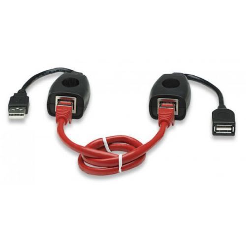

I'm going to use one of these, it can reach 60-70 meters using an ethernet cable, max speed 12mbs -usb1.1. Already test it, and it works. You can find better ones that reach 100 meters but they are pricy. 60 meters is fine to start with.
Connection will be: pc----->usb ethernet converter----->60-70meters of cat5 cable----->ethernet to usb converter----->usb hub----->hd webcam(port1). /  arduino mega(port2)
Does anybody knows if A 12mbs usb connection supports an HD 720p webcam??
The problem is that the computer will comunicate with the arduino, using serial comunication, on the same cable of the webcam. I'm not shore that 12mbs is enough for both. Any body knows how many mbs takes an hd webcam? Otherwise I can always use a normal webcam.

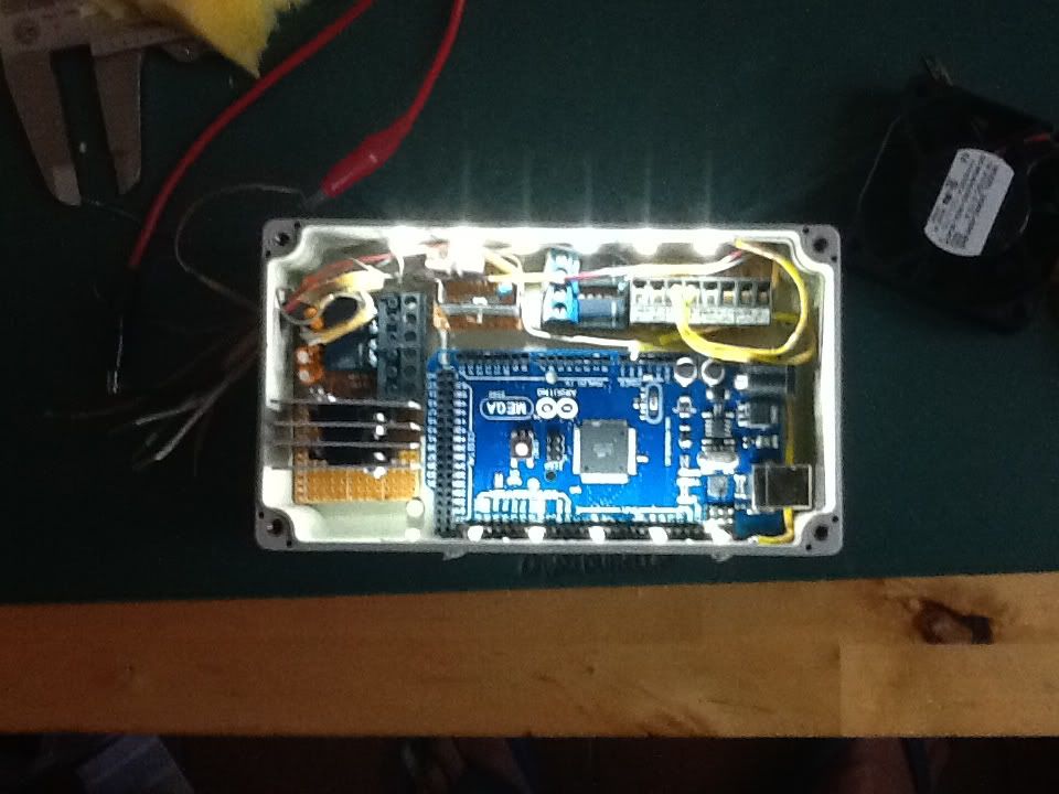

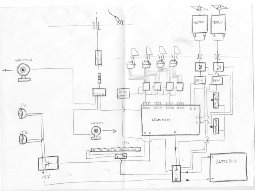

This is a drawing of the electronic connections inside th rov + some photos of the electronics box already finished.
The electronic box works at 12 Vdc. It contains:
Arduino mega
Relays for outside Leds
Relays for internal strip Leds (just for fun)
Relays for 2 motors direction (fw-left/bw-left+ fw-right/bw-right)
Tip31c transistors for motors speed
5v voltage regulator (for steppers)
Plus 2 smal pc fans for cooling the transistors and the volt reg
I'm sure that USB 1.1 is to slow for HD webcam and feeding 2 of them + Arduino control would surly be to much. Could you use an Ethernet shield and a 4 port Ethernet switch to plug I/P webcams and Arduino into? You would then get faster data transfer and could maybe use power over Ethernet to drive the ROV but have on-board backup battery.

I bought a logitech c170, non hd. It works without problems with the cable we have.
I can send serial to arduino mega while The webcam is working.
I think the topic is resolved.
