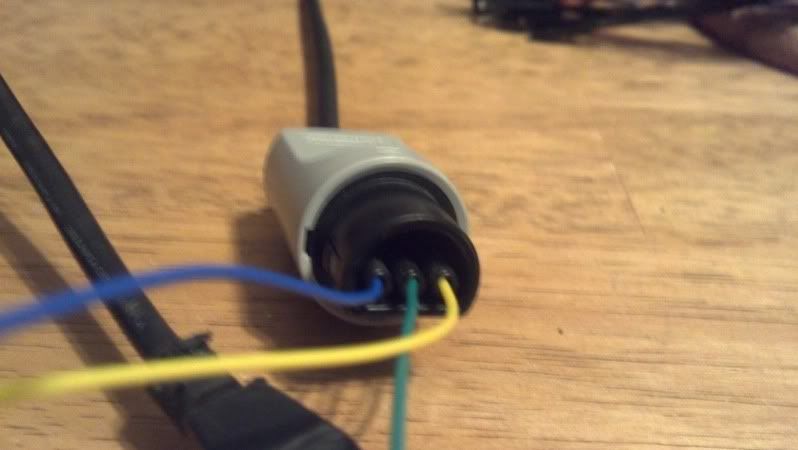

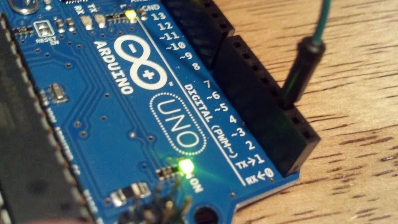

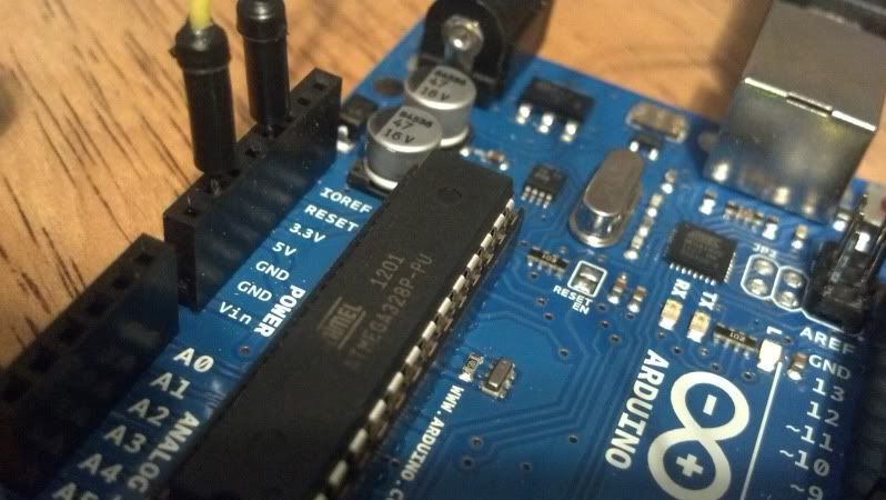

So I bought the Ardunio in the mail and got it today.  I also ran out and got some wires that have connecting pins on each end.  With a type B USB cable, I was all ready to go.  I hooked everything up like we have been discussing in this thread and there seems to be a disconnect somewhere.
Here is my hookup.
I took three wires and stripped them like this:
And plugged them into the controller port like so:
Heres how I plugged in my pins.
Blue > 3.3v
Green > Digital Pin 2
Yellow > Ground
(Blue and Yellow are switched in the pictures, opps!)

I have ran a small pin 13 led code that worked on the board so I know the board isn't faulty.  I have also changed out N64 controllers to make sure that its not the controller.  The only other thing it could be is a faulty USB cable (which I think is not likely since the code gets sent successfully) or there is something I'm not doing right in this cable hookup.  Can you guys catch what I'm doing wrong?  Since I know nothing of any of this, your help is gratefully appreciated.  Thanks guys, later.
Sowden
Alright, I ended up getting it to work.  I didn't know I had to open the "Serial Monitor" for the Ardunio to start transfering data.  I realized I had to have Processing 1.0 running for my computer to read the signals coming from the N64 controller.  I downloaded the N64_Controller.zip from the link above and played it to get it to read the controller.
