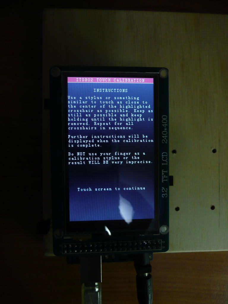

I have a ITDB02-3.2WD - 3.2" Widescreen TFT LCD Screen Module with SD and touch screen & the ITDB02 Arduino MEGA Shield.
I have programmed it to do all the things I want except the Touch functions. I thought I would start with the the Touch calibration.
I have made the required changes to the calibration code & the libraries, the code compiles, uploads & displays the startup screen as per the picture. It says "Touch Screen to Continue" I do that but nothing happens, nothing at all. I have search through the forum but cannot find any clues to what might be wrong.
Can anyone help me?

It appears the Touch screen works as I stumbled on  a file (_16_9LCDTest) that has code to demonstrate handwriting on the screen. The code sets all the parameters within the code & doesn't use "#include", so at least the hardware seems fine, when you touch the screen the dots appear.
I still have no idea what is stopping the other code from working.

Hi Firefox
Did you get this sorted as I am having the exact same problem. The sketch you referred to earlier works OK so, I agree, that the hardware is fine.
I have also been able to get the sketch referred to in this post working : http://arduino.cc/forum/index.php/topic,119000.0.html although there is a small error in the sketch were he displays the X axis both times - just change the last print line to display the Y co-ordinate rather than the X co-ordinate again.
My plan now is to review the sketches provided by Henning Karlsen to see if I can identify what the problem is - should be easy because the sketch in the linked post uses the same libraries  smiley-confuse

It is getting late but I think I have the answer - change the precision to PREC-MEDIUM.
It appears that PREC_LOW does not work too well  smiley-grin

Magicj
Sorry I have been asleep on the job smiley
I haven't got it working, I'm pretty sure my setting is Prec_Medium. I have given up for the moment but if you have found solution I would love to know what it is.
I think there may be a conflict software wise with a Remote Control library I am using but as I am software challenged I have no idea how to test or rectify it.

Firefox
It looks we we have the same hardware with the same problems smiley-grin
Can you try this for me...
Load the 16_9 sketch you referred to above and then load the calibration sketch - I have found that the touch panel will now work.
Assuming you have the same result, I suspect that there is something lacking in the ITDB02-Touch library initialization section. I will see if I can identify what it is, although I am still in the learning phase with some of this stuff smiley-slim

Hi MagicJ
I have also found that I can get the Touch to work but only when I load as you mentioned. As soon as I try reload my code with all of the Touch coding in it nothing happens. It's too big a mental challenge for me, as far as I can tell everything is as it should be in my code.
