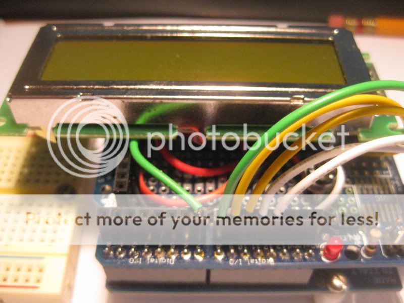

I have a 2 x 16 parallel LCD.  It is attached to a protoshield attached to a UNO.  It works fine on "Hello world" but when I have it hooked up to a thermocouple, it gives the Int temp as -127 and states T/C Problem.  Then it goes bonkers with all 32 characters rapidly changing with various symbols like #,@,&, sigma and omega, etc..  Then it shuts down and then repeats.
However, the serial monitor sketch works fine and shows the proper temperature.
The LCD thermocouple sketch is from LadyAda who sells the TC and break out board/amplifier so I assume the sketch is not the problem.
This was a very inexpensive LCD - as a total noob, I am wondering if that could be the problem?
Any suggestions or recommendations would be greatly appreciated.
TIA

Since the LCD works with 'Hello World' that implies that the connections between the LCD and the Arduino are correct.  That leaves us suspecting a problem with your implementation of the sketch from LadyAda.  Don't you think that you might get more help if you provided us with a copy of your version of the sketch and a photograph of your protoshield hookup?

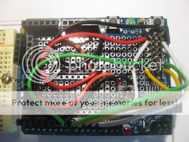

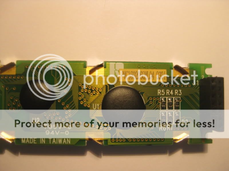

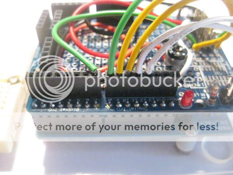

Here are some photos but as you said, it must be hooked up to the UNO properly for "Hello World!" to work
Pin one is top right in the next shot
The pinout for the LCD is  11-RS to UNO pin 11, 9-EN to UNO pin 12, 4-D4 to UNO pin 7, 3-D5 to UNO pin 8, 2-D6 to UNO pin 9 and 1-DB7 to UNO pin 10
Hope this gives you the information you need

try using pins 7,8,9, and some pins other than 10,11,12 for lcd. Your temperature sensor is using pins 11-13, possibly 10 too.
