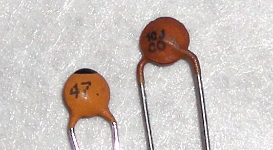

I recently bought a capacitor assortment and am confused about the values. The chart below lists the capacitors and their values as is advertised on the web page on ebay. The ufd values seem to make sense but not the pfd values. According to two different sites with either a table or a calculator the markings should indicate the following values:
100 = 10pfd
221 = 220pfd
471 = 470pfd
The 100 and 221 above codes and values don't match the chart below.
As far as the codes of 10 and 47, I can't find any information as to what values those codes represent. The characters printed on the capacitors do match the numbers under the 'Code' column. Can any of you experienced fellas straight this out (if need be)? - Scotty

Thanks for responding. Shouldn't the one listed as coded 100 be a value of 10 with 0 zeroes, making it a 10 pfd capacitor? To be a 100 pfd capacitor shouldn't it be coded as 101? What are the pfd values of the ones listed as 10 and 47? They are marked as shown below. The 'J' is tolerance correct? - Scotty

The capacitor with the black top is an Asian 10PF NP0 capacitor and the one marked 47 J is an old Centralab 47 PF type J material which isn't real temperature stable and typically used for non critical coupling tasks typically used for radio frequency coupling task's

oric_dan
I'm pretty darn certain that 100 = 100pF and not 10pF, but 221 and 471 are
220 and 470 pF. Inconsistent, as it may seem. Anything under 100 pF will
just be the number stamped. 10 = 10pF, 47 = 47pF.
Tom Carpenter
Yeah, for those <1000pf, sometimes the actual value is written on rather than the encoded value. So 100pf can be either 100 of 101. The latter of the two is correct according to the specifications, but I have seen the former used before.

Thank you all for your replies. It's clear to me now. Thanks, Tom, for the link to the code chart. I've got it bookmarked. While doing some searching for an explanation of capacitor codes, I read that some meters can read capacitance. Made me want to know if my Centech meter could. Yep, it can. I know Harbor Freight can sell some cheap stuff but I really like this meter.Easy to use, read, and very versatile. - Scotty
