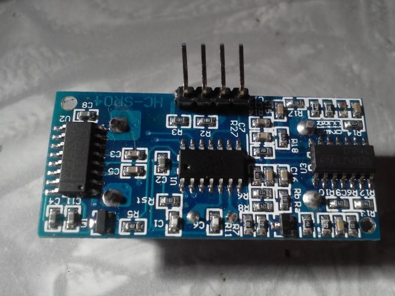

I received a new sensor in the mail today that works just fine. After comparing the two boards, I noticed that capacitor C12 is missing from the top right corner of the board. Any idea what a suitable value is for this capacitor?

Unfortunately you can't estimate the capacity of a smd-capacitor by size/ footprint.
Is the cap missing on the newly received board? Send it back, don't try to fix it.
If it was the other nonfunctional board, try somtething between 10nF and 100nF .
