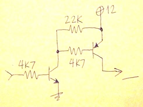

It's pretty easy to use an NPN to switch the gate voltage.
See attached.

If you need a "high-side" switch, and have an NPN and a PNP...
With a 2N3904 and a 2N3906, it's good for at least 100mA, where Vout dips to 11.8V

Im using this http://rohmfs.rohm.com/en/products/databook/datasheet/discrete/transistor/mosfet/r6010anx.pdf and that last circuit I guess would work but wouldn't the vout be 11.3ish? Since the. 7v drop of the transistor? But now alos what would I do drive it low? A pulldown would waste energy and steal from the gate voltage as well
Turning it on idk if it takes 1ms to fully turn on but turning off id like to make as fast as possible
basically it will be receiving the output from a 5v comparator deciding whether it is on or off, id like to drive the mosfet in one step if possible but with the smallest footprint
There's no 0.7V drop because it's all about Vsat.
As I stated, at 100mA, that gets up to 0.2V.  Drawing less current results even less Vsat.
It's a tested circuit!
The PNP opens and closes the path to +V (12V), so its output is +V (less Vsat) when it's on or it's "open circuit" when it's off.
It's pretty fast.  The MOSFET switch time will have more to do with your Gate pull-down (and Gate capacitance).
A high from the Arduino output turns the NPN on, which takes the PNP base low, turning the PNP on, and enabling the final output.
The first circuit is the "easiest".  Its only drawback is that it needs a high to the NPN to turn the FET off.

Its only drawback is that it needs an active HI to the NPN to turn the FET off.
If that's indeed a drawback, tie the 4.7k to 5v and put the arduino's otuput pin to the base of the npn. Turning arduino's pin as input turn on the npn. If you had pre-written a 0 to the pin, turning it into output turns off the npn.
