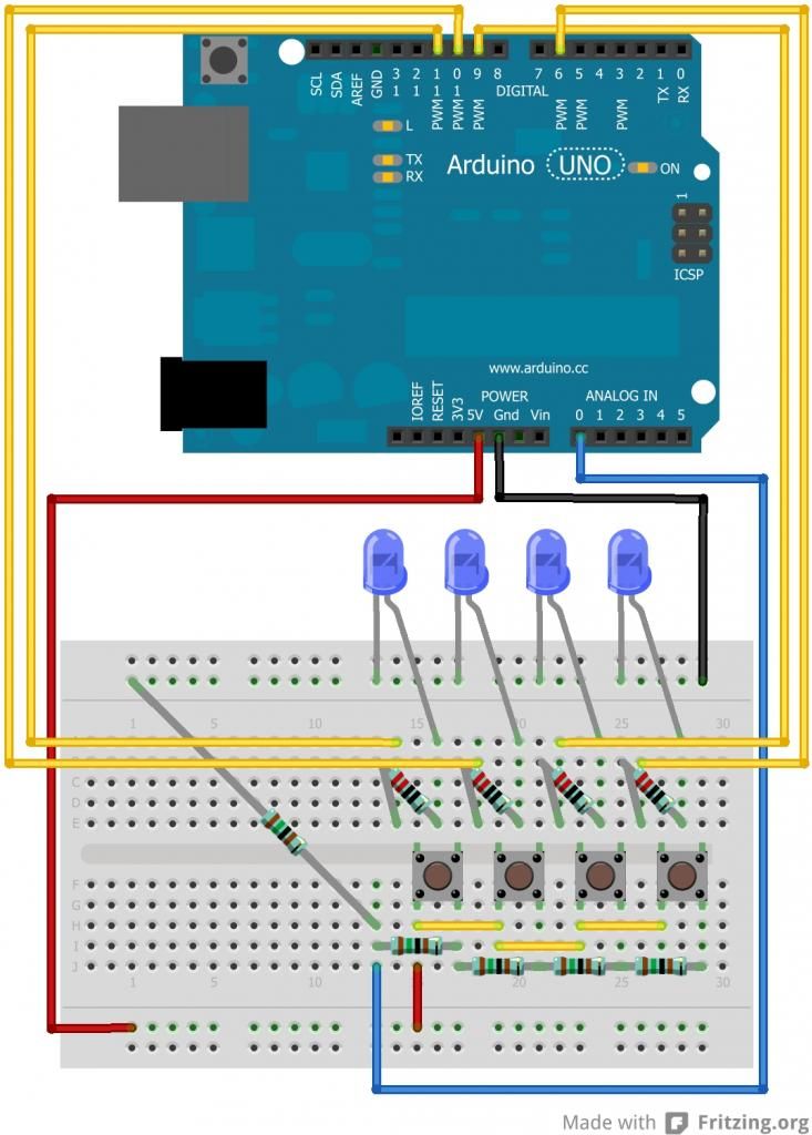

Hello everyone, I'm new to the Arduino community and have only been learning for a couple of days. I have greatly enjoyed learning and have discovered a lot from looking at these forums. However I'm stumped on my latest endeavor.
I've managed to get each button to control a separate LED through a single analog wire. The problem is I can not figure out for the life of me how to not continue to repeat the effect. For instance, when I press button one, led one increases in brightness. If I hold down button one, led one continues to cycle through it's brightness level.
In short I just want a held button to act as a single button action and not continually repeat. One press, one action, until it is released and pressed again. I've tried several ways of doing this to no avail so I'll share my raw setup up and code. If you can help that would be great, and feel free to be honest if I've just done something completely backwards. I may be a noob but I can take some criticism. Thanks in advance.
And of course, if you want to use this code and/or setup feel free, just please share your uses/discoveries.  smiley
Here's the setup:
And here is my code:

The code is a bit confusing. I would write it so that the first thing you do is to set a variable that indicates what switch is being pressed.
Then write the code that does the action you want.
You will need a variable that notes the time when the button was first pressed using millis(), so you will need another that notes what switch was pressed the last time through the loop. I can't see any of that in your code and you need that sort of information if you want to do what you say.

Look at the blink without delay example, that is the basis of what you want to do.
You get the time now with millis and compair the time now whit the time you want certain actions to finish or change.
Also look up the concept of a state machine it is what you want to implement.
