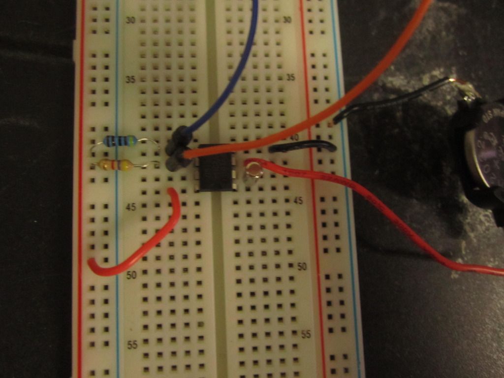

Homebrew, but here's my part list:
Product: Plastic Battery Holder 1-cell ø20mm PC 120591-1
http://www.dipmicro.com/store/BH120591-1
Product: Lithium Battery CR2032 Ф20mm 225mAh 3V CR2032
http://www.dipmicro.com/store/BAT-CR2032
Product: 4.7k Ohm 1/4W Resistor ±1% 4k7 472
http://www.dipmicro.com/store/R3F47-4
Product: 32.768kHz Crystal Cylinder
http://www.dipmicro.com/store/XC4-32768
Product: DS1307 Dallas Maxim 64 x 8 Serial Real-Time Clock DIP8
http://www.dipmicro.com/store/DS1307N
And I wired it up based on the 'typical operating circuit', except without the scl being pulled to 5.5V.
It's also all wired up on a breadboard.

Possibly worded a little awkward, but 'have a pullup voltage...' means also having a pull-up resistor. The I2C standard dictates that both data and clock signal use external pull-ups as these signals are bidirectional so they cannot rely on one side always providing a valid logic voltage level output. The actual value of the pull-up resistor can depend on things like the speed the bus will be operated on, the number of slave modules wired to the bus, that total length of the bus, etc. But 4.7K ohms is a pretty standard recommendations.
 Now to confuse you further (not intended, really) one can sometime get away with wiring a I2C device to an arduino board with no pull-ups at all. That is because the arduino I2C library enables the internal 'weak pull-ups' on the open drain clock and data I2C pins. I've run a 1307 I2C RTC module with several of my arduino board without using external pull-ups and it works fine, however that is not per I2C standards and is not be a recommended practice.

I only have one 4.7k ohm resistor, so I had both SDA and SCL going through that to the voltage, but then that turned the entire system off, outputting nothing to the serial monitor. Is this just a case of requiring another resistor?
One other thing I should note is I have SQW/OUT wired to nothing.

Very strange things are going on. I rewired almost everything with shorter wires like you suggested (I was using cheap male-to-male wire connectors and switched to stripping solid core 22 gauge wire) and this time I did nothing to pullup SCL, like before. This time the output seemed to be working, but displayed the time as 3:50, which is approximately the time I tried pulling SCL up with the same resistor as SDA. So I tried pulling SCL up again, and just like the last time I pulled it up, nothing worked and nothing output to the serial monitor. Just afterwards I tried the circuit without pulling up SCL and this time it reads 4:39. The actual time was 4:41, and 4:39 is when I tried to pull up SCL.
So I did this procedure over again, except tried to switch it as fast as possible, between having a pullup resistor and having no pullup resistor for SCL. I found the quicker I can switch it, the more accurate the time displays. So for some reason the chip's time is set when SCL is pulled up, but can only display the time when there's no voltage?
Just took some pictures, they'll up in a couple minutes.
Using one resistor wired to +5vdc and then to both SDA and SCL signal lines results in just shorting the two signal wires to each other, a total disaster as wiring schemes go. Yes each signal line requires its own separate pull-up resistor.

Sorry!  smiley-red Had to sprint out the door to radioshack to get another 4.7k resistor before they closed.
Well, it seems to be working now that I have two separate resistors. It's still approximately one minute behind but I'm not too bothered by that.

Here's the pictures if you were still curious:
The Battery on the right kind of got cut off, but that's what the red and black wires disappearing go to.
No Pullup resistor
Additional pullup resistor added
