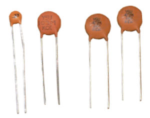

Maybe the capacitor ?
I used one like this, of 100nF = 0.1µF
