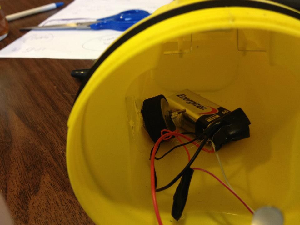

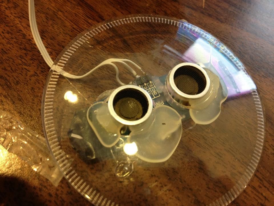

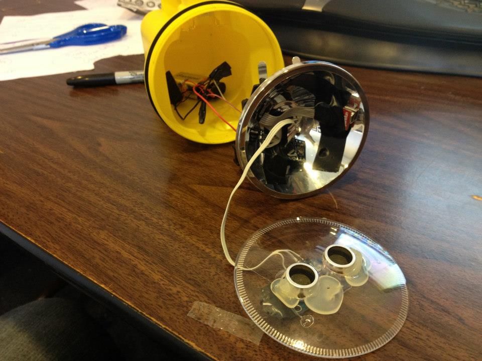

Excellent smiley I believe that's all I needed. And you guys have my code so if anyone wants to make one feel free smiley
Here's some pics for the project
