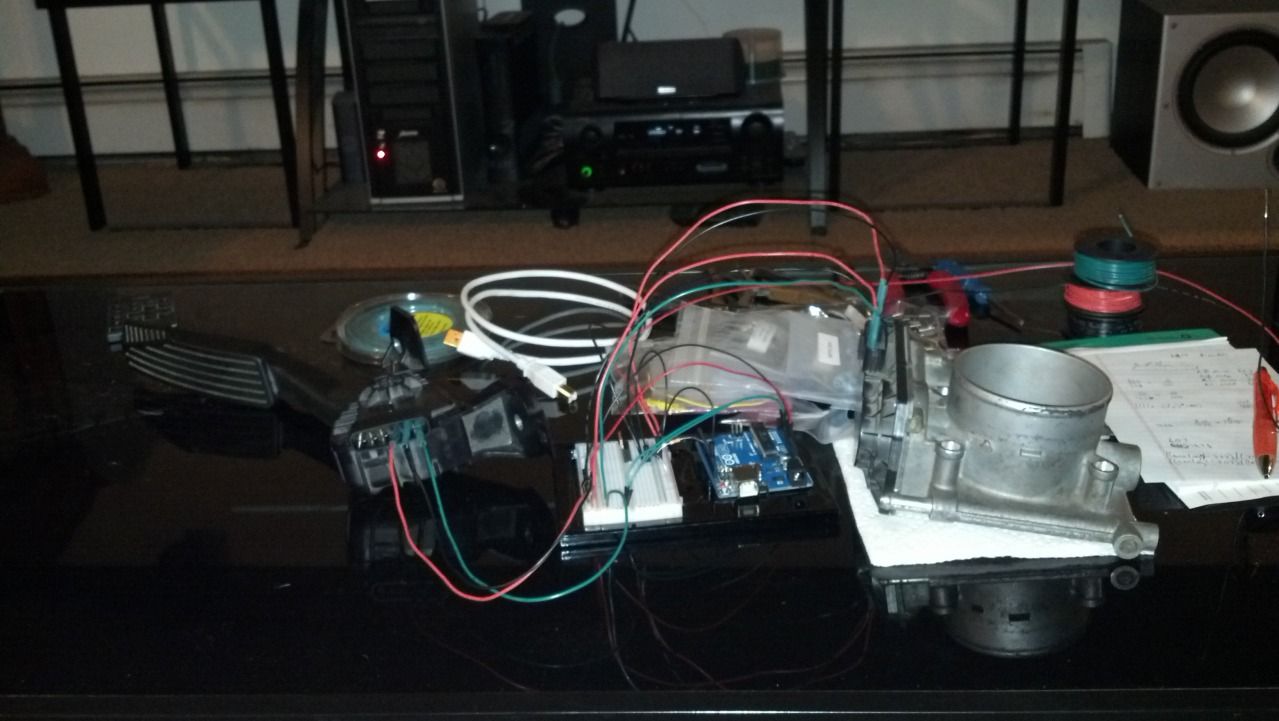

Once I had the pedal reading 0-100% I started messing around with the throttle body. I was able to do the same thing for the Throttle Body Position Sensor (I converted it to 0-100 also). Once these two were working as inputs, I started messing with the Throttle Motor. I took a 12v source (a car battery) and gave power and ground to the two pins for the Throttle Motor; it turned open extremely fast. If I switch the power and ground to the opposite pins, it tried to turn the other direction. I started researching how to control stepper motors through PWM and found this:
http://bildr.org/2011/03/high-power-control-with-arduino-and-tip120/
I used the second diagram:
http://bildr.org/blog/wp-content/uploads/2011/03/tip120-motor.png
But I didn’t have the components that they use in this example. I looked through the stuff that came with my Boost Solenoid and found a transistor and some other components. I hooked everything up the way the second diagram above suggested and was able to use the analogWrite() function to write out to the motor through PWM. Finally I was able to get all three parts working individually (Throttle Pedal Sensor, Throttle Body Sensor, and Throttle Motor). Since the analogWrite() uses a value of between 0-255, I figured I would map the Throttle Pedal Sensor to 0-255 and write the value directly to the Throttle Motor. This resulted in the Throttle flying open extremely fast (once I pressed the Throttle Pedal down just the slightest bit) and staying there until I shut everything off (regardless of the position of the Throttle Pedal after initially pushing it down). I was pretty confused as to why 0-255 wasn’t the same as 0-100%. As I read about PWM and duty cycle it started to make a little more sense, but I’m still a little confused about things. I then mapped the Throttle Pedal Sensor to 0-120. When I did this, if I recall correctly, the Throttle Motor opened and closed relative to the Throttle Pedal (though a little laggy).
Now I have control over the Throttle Motor by using the Throttle Pedal. I don’t feel safe quite yet running it on my car, since it doesn’t react as quick and as consistent as I’d like. I think it will take some more playing around with. I think I’m going to have to add some logic to check where the Throttle Motor is at (based on the Throttle Body Sensor) and compare it to the position of the Throttle Pedal Sensor. For example, if the Throttle Body Sensor is less than the Throttle Pedal Sensor, keep opening the Throttle until the Throttle Body Sensor is equal to or greater than the Throttle Pedal Sensor (then else if the Throttle Body Sensor is greater than the Throttle Pedal Sensor, do the opposite).

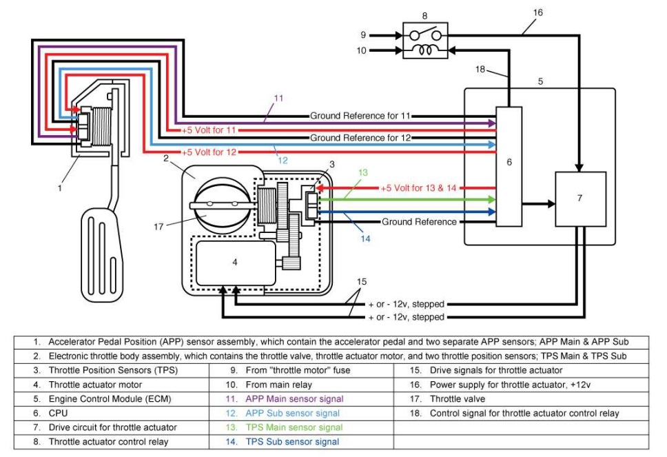

2. Both the Throttle Pedal and the Throttle Body have redundant sensors (each have two sensors). Would you suggest using both of these sensors for each as inputs to verify they are the same value for safety? (For example, is Throttle Pedal Position 1 equal to Throttle Pedal Position 2 and is Throttle Body Position 1 equal to Throttle Body Position 2?) I assume Mazda did this for a reason? Here’s an almost exact diagram, though I don’t think this is Mazda’s: http://www.rx8club.com/attachments/tech-garage-22/160725d1281667405-throttle-position-sensor-problem-dbw_1-jpg

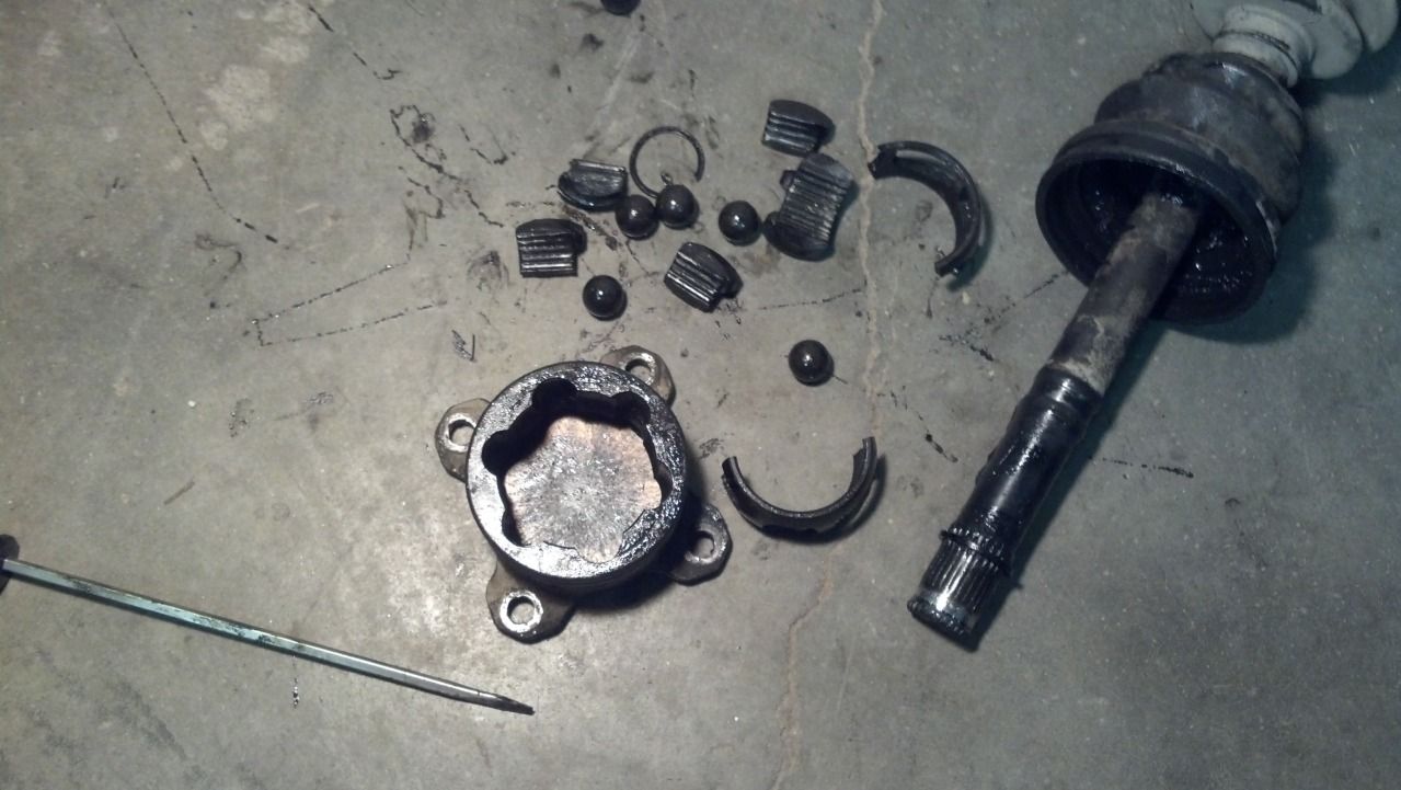

Had to chuckle at the broken lobros. I've never broken one there, on my setup the half shafts are the weak link. I've got a design now that will last for a few years, but they always go eventually. Curiously, every single half shaft failure has been when I was pulling away gently and not *quite* spinning the wheels - which your grip theory will tell you is where you are getting peak traction. So you may find that by getting a better hook-up you actually give your transmission a harder time, although there's less smoke and noise.
The algorithm I referred to was the strategy of when and how much to use timing retard, spark cut, throttle close etc to drop power. I wouldn't worry too much about the details of PWM at this stage. Are you really going to convert to throttle-by-wire? That has significant safety implications and I'd be wary of a DIY solution for that. It's not going to be too hard to make it work, but you have to look at how many parts have to be working in order for the throttle to close on demand, and think about how many wires and joints and sensors there are waiting to go wrong. This will be why the OEM installation has redundant sensors everywhere. A throttle stretcher would be much, much safer because ultimate control remains with your right foot and all the system can do is take power away.
I was told that these joints would break with RPM launches on a sticky tire. Guess I had to see first hand… My usual course of action is, if it breaks, build it stronger. I broke my first two LSD’s, then bought everything to make the third one stronger (Detroit True Trac, new bearings, seals, lower gear ratio). Then I broke my stock trans. Here’s what happened there:
It beat the hell out of it for 2-3 years, so I guess it did pretty well for the abuse I put on it. I upgraded to the transmission that came stock mated to the motor that I swapped into my car (the stock motor was a 5M-GE and the stock transmission was a W58; I swapped to a 7M-GTE and a R154). Also, since I changed transmission I needed a custom driveshaft, so I now have a one piece.
The plan is to have custom axles made, a friend of mine had some made for his 280z that has a Ford differential in it. The shop that made it was: http://www.driveshaftshop.com/
Did you still keep it an IRS?

I messed around with some of my Arduino stuff last night. My roommate grabbed his nitrous bottle, bottle heater, nitrous gauge, nitrous pressure sensor, a car jump pack, and the two solenoids (one for gas, one for nitrous). I was able to get a reading from the nitrous pressure sensor, which was simple because it was the same as all the other sensors I’ve messed with (three pins: 5v, reference, ground). The jump pack was dead, so I didn’t have a 12v power source to try working with the solenoids. But we started looking into whether the one transistor that I’ve been playing with will work with the solenoids. Each solenoid is a 12v and produces up to 8 amps. I need to read through the section in my electronics book on transistors so I can get a better understanding of how they work and hopefully be able to figure out what the values on the transistor’s datasheets represent. I also need to look into ordering an LCD display. I’d like to use one on both projects to display some of the data coming from the sensors (psi for boost and nitrous, amount of throttle being reduced by the computer, etc.). I’m also thinking about looking into a solution to adjust boost levels. For example: on pump gas I’ll run 20psi, but on race gas I’ll run a higher amount (probably 25-30psi). I may have a switch with a guard: when the switch is down, it will be 20psi; when it is up it will be 25-30psi.

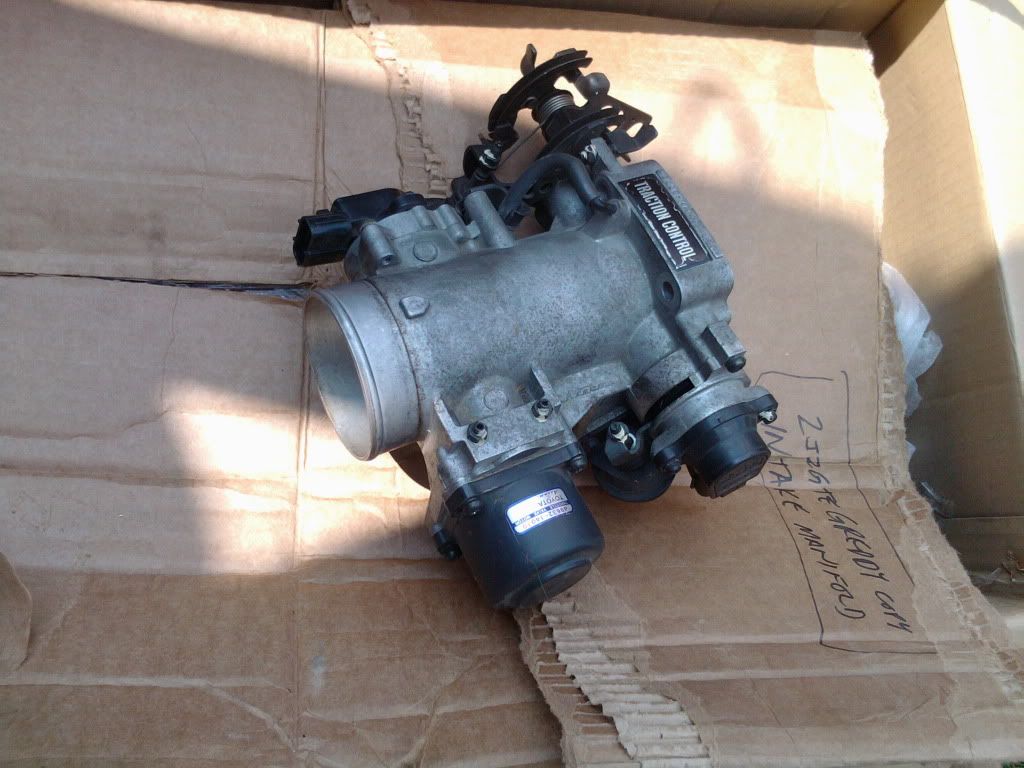

I don't know if that's what that picture shows. Anyway, throttle-by-wire systems are getting more common and it would be kind of cool to have an engine that had automatic launch control and automatic rev matching and so on which would become possible once you have the basic system in place. Just make sure that you consider *all* the failure modes and ensure the t-b-w system will kill the engine if it loses control over the throttle.
The picture shows a 2JZ-GTE throttle body, it utilizes two butterflies. The front butterfly is controlled electronically and the back is controlled by cable (which actually has two cables, one for the throttle pedal, and one for the cruise control). Either way I plan to be thorough in dealing with safety. But it makes sense to try to use a throttle stretcher if it can eliminate two issues: Mounting a different throttle body and ensuring safety.
