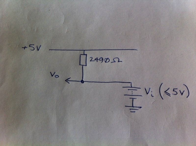

Here is (I think) the circuit that forms part of my project:
The value of the resistor (2490 Ohms) is fixed. Vi is a variable voltage (driven by the Arduino PWM output - might be filtered but let's just assume it's a nice, clean DC voltage which will never be greater than 5V). What will Vo be or is it not possible to tell? If it were possible to disconnect the resistor, then I'd do it, but it's inside some other electronics to which I don't have access (a Megasquirt EFI controller).
Also tempted to put a diode in between the Arduino (Vo) output and the node but not sure if this is necessary?
bobthebanana
Vo will also be exactly 0 or 5 volts since the arduino output will sink the tiny current flowing through the resistor when it's LOW (0 volts)
dc42
The value of Vo depends on the source resistance of the voltage source Vi. If we call this resistance R, then in the absence of a load:
Vo = ((5 * R) + (Vi * 2490))/(2490 + R)
So it all depends on the value of R. If the voltage source is an Arduino pin followed by a simple RC network to smooth out the PWM, then R is the resistor used in the RC network plus about 25 ohms.

jackrae
Looking at it simply: On the basis that Vo is not required to supply current, the resistor is irrelevant to your calculations.  Since Vo is electrically tied to Vi then Vo is always equal to Vi.
This, of course assumes the output impedance of Vi is zero.  In reality, if Vi output port has impedance, let us call it Vi(imp), when set low, then the value at Vo will be the algebraic solution of the potential divider set up by your 2490 resistor in series with Vi(imp) and the actual value of Vi(low).
Similarly the value of Vo, with Vi set high, will be dependant upon the actual value of Vi(high) and the impedance of its output when set high.
jackrae
Mr Henry,
You are perfectly correct.
My bullsh*t statement is exactly that ;  since Vi is the voltage seen at the output terminals and is directly connected to Vo, then Vo = Vi.
The impedance of the output port and the respective Vi(low) and Vi(high) are of no consequence.

spandit
If Vo = Vi then that's great. Thanks for all the replies - I think I'll breadboard it and hook up a DVM to check!
dhenry
jackrae: I hear you. It is always easy to complicate matters.
Quote
Look at it this way: Vi and Vo are connected via a wire (of zero resistance). So Vi cannot differ from Vo.
Now, if Vi is the specified voltage on that battery with high output resistance, it gets slightly more interesting. But a regular battery / power supply will have output impedance far lower than that resistor's (2490ohm) so even if they differ, it is immaterial.

Fair point! The node (where we're measuring Vo) is the input to a Megasquirt EFI controller which normally measures the voltage across a potential divider (between the 2490Ohm resistor and a thermistor). I'm giving it a voltage feed from an Arduino instead (the software is taking the average of 4 thermistors and combining them into 1 output whilst also displaying all 4 on an LCD bargraph). It's more or less finished but probably needs a few tweaks
dc42
And how are you deriving a voltage feed from the Arduino? If it's from a PWM pin and simple RC smoothing filter, then you need to take the source resistance of the RC filter into account. If you follow the RC filter with an op amp used as a unity-gain buffer, then its output resistance will be low enough to ignore.
