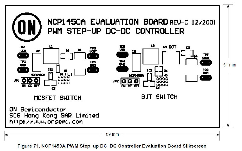

Well measure all the voltages and supply current both before and after activating the chip-enable line.
Your PCB layout seems poor, you have long thin traces where there needs to be short wide traces (to both capacitors).
Short = a couple of mm if possible.  There's no point using low ESR and low ESL capacitors and then putting them at
the end of 10mm of thin PCB trace, that defeats the object.   A 2-layer board is going to be a lot easier to get working
as the ground return path can be directly underneath, keeping stray inductance right down.

Allright, this goes two ways.
Included from the NCP datasheet the original design of the evaluation board:
Now I don't have the exact same components, so this is my take on it:
I couldn't squeeze the small line underneath my diode, so it goes underneath my coil. Note: on the image my coil is large and circular, in reality it fits on the pads, so ignore the big circle, it does not create space conflicts. As far as I can tell the board is single sided, is that safe to assume? I have no idea what the 12 little white circles in a grid are on the original design.
So far my SMD design. If all is well I can have it etched tomorrow.

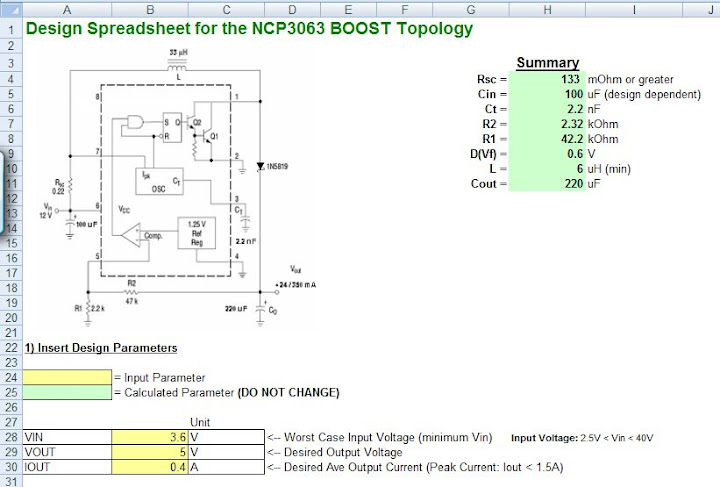

I have been looking into the NCP3063 as well and found a very useful document from OnSemi:
http://www.onsemi.com/pub/Collateral/NCP3063%20DWS.XLS
The excel sheet helps to select components. I entered my desired values and got some results:
Now this raises a few questions:
* a 10 uH coil will be good as well, since they say "minimum" ?
* do I need special (ESR / tantalum / ?) capacitors, or are any regular capacitors sufficient for this task ?
* D(Vf) is the diode forward voltage as far as I can tell, but they recommend 1N5819, which i now see is available in 0.6 Volts Vf. However, should I stray from this value, should I go higher of lower?
Here's the thing with the "minimum" disclaimer. While your circuit may work and give you the output voltage you're expecting, it may not hold that output voltage for higher loads.... i.e. at higher loads, you may start to see your voltage come down sooner.  Play with the values and test.
But, if you select a too big an inductor, for a given load resistance (current draw), your DC/DC converter may not startup.
You can use aluminum electrolytic, just make sure it's low ESR.  If you're breadboarding this to play around and experiment, you can use ordinary elect caps in your parts bin but when you buy your final parts, use a low ESR model.
A big Cout means lower ripple voltage. But Inrush current may be too high. Measure it during startup and see if you're comfortable with the values. i.e. at normal loads, your converter may be drawing 200mA, but at startup, it could shoot up to 800+mA for an instant.
For some configuration, (like Inverting) using a smaller Cout actually was actually more beneficial (better performance, higher load capability) than a big Cout. But then ripple will be high.... what to do?
You can hang another LC filter at the output of your converter, and you can reduce ripple (and clean the output too very nicely) by another 50%!
What's important here is to use a schottky diode. You can't use an ordinary diode... it'll get hot. The 5819 will work or any schottkey diode (say you used another SMD part).
Other than the schottkey diode, you can use whatever parts you may have in your parts bin. Efficiency may not be as high, or ripple may be larger depending on the kind of parts you put together.  You can breadboard this and see the effect of your chosen part (use a scope, voltmeter, ammeter and a load).
Just remember, this is a game of tradeoffs when it comes to component selection. Depending on your chosen components, your peak efficiency may be at lighter loads, or heavier loads, you'll either get a lower ripple or higher ripple, lower inrush current, higher inrush current, failure to startup beyond a given load, or reliable startup everytime at your maximum load, size, and cost.  Test test test for your specific load and application.

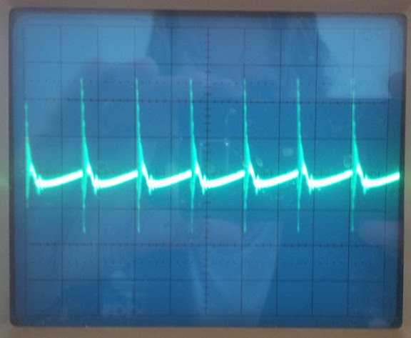

All right ! We have success !
We etched the board and got quite a good result:
Populating it resulted in this figure:
At first I didn't work, we seemed to have broken the coil, we replaced it with a new one and... 5.05 Volts ! Hooah !

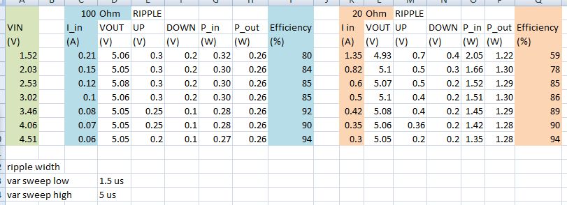

So I attached a scope and did some efficiency tests.
This shows the image of the riple generated by the booster. The upward spike is generally about 0.3 Volts, the downward spike about 0.2 Volts. The booster has been tested without another RC circuit for filtering out this ripple. Results look good. Efficiency test results:
So indeed if V_in is rising a better efficiency is achieved. I then connected a laser tagger to the dc booster, it even ran @ 1.5 Volts. So today a great success, this looks really good, thank you all so far for your contributions, it really helped out.
