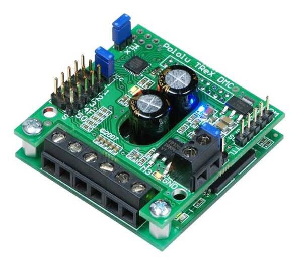

If I was using one of these motor controllers which can accept all sorts of protocols for sending commands, what would be the best way send commands down a cat5 cable to it from a long distance like 100ft? It's not a wiring question but a question of which command protocol will still be interpretable by the controller 100ft down a wire. Or, which protocol could most easily be made to work that far.
http://www.pololu.com/catalog/category/96

For that distance I would use asynchronous serial RS-232.

should I just use an arduino serial out to do that? Anything special needed for this scenario?
You'd need an RS232 driver at each end.

why can't the arduino do it by itself?
Because RS232 has voltages that are +12V and -12V, the arduino can only output 0V and +5V. It is the TTL option.

In the picture I see TTL on the board. For only 100' a servo control signal might work.
Yes especially if the TTL was driving an open collector transistor with a pull up to 12V or so. But he did ask what I would use and that is RS232.

If I am asked what I would do then why should I reply with something I would not do. You have to admit that sending TTL down a 100' line is not a sure fire hit is it?

You could use a current loop.
OR
Does anyone know if I2C would work?

Quote
Yes ..... No

what if you buy a shielded network cable, you might get away with 5v logic
