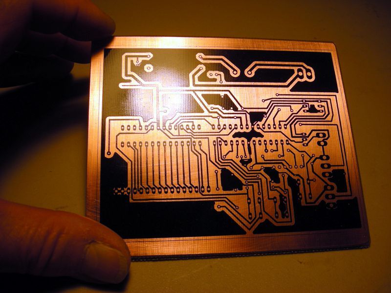

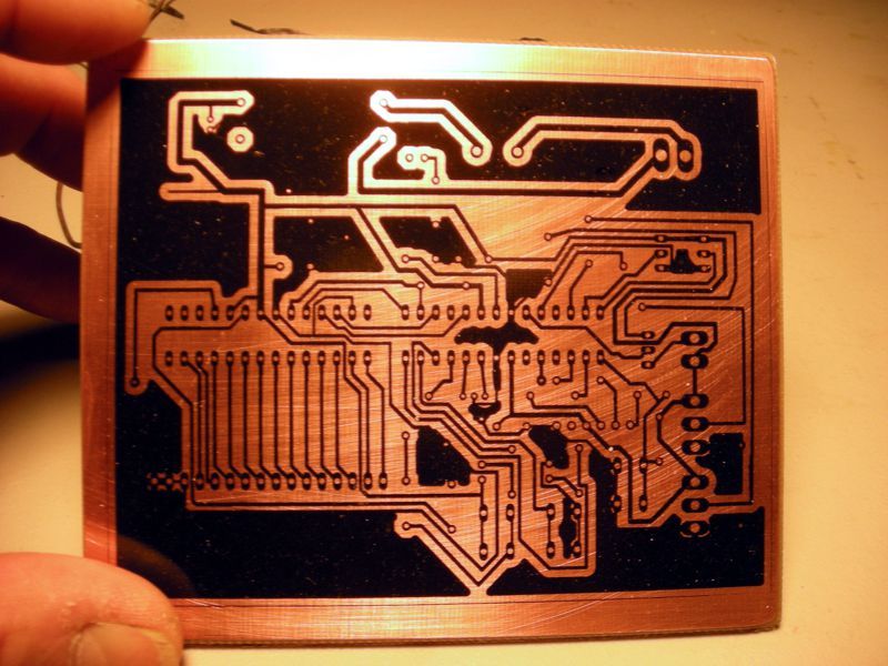

Hello All. After having tried transferring a laser print from magazine pages and obtaining 'not good enough' results and being reluctant to spend money on photo paper while not being sure what the 'right' photo paper is, I came across some info on the net about another transfer media. I have rolls of this stuff on hand so it was a cinch for me to try. Right off the bat, with no fiddling around, it worked very well. Below are some images.
The media is cheap sign vinyl. Here are some pluses:
It's cheap and should be availabe at a local sign shop or the internet.
It transfers every bit of toner to the board.
It readily releases from the board. No saturation in water or rubbing of remaining paper is necessary.
The back of the vinyl is adhesive so no need to tape it to a paper carrier.
- Scotty

Link is good. Thanks for that. No, the substrate that the manufacturer uses to carry the vinyl is not what is printed on. It's the vinyl that is printed on. Once it is printed it is placed onto the board, print side down, and the toner is then transferred to the board using pressure and heat.

How well does it work for thin pitch? (0.5mm) The problem I have with my photo paper is that with fine picthes (less than 1mm) the photo paper gets transfered and stuck in between traces along with the toner. I end up having to scrape in between traces with a knife.
You will not have that problem with vinyl. Only the toner gets stuck to the board.
Thanks for the video link vasquo, that helps very much to make the process understood.
As for two sided boards, clear vinyl is available. Otherwise I was thinking that transferring to one side of the board and then using a couple of drilled via holes to index the other side would work.
