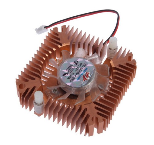

At first glance that heatsink/fan looks small for 50W... think they're for 5-10W LEDs. THere are some nice big, round LED heatsinks on ebay that should work without a fan. Is there good airflow in those ceiling fixtures?
http://www.ebay.com/itm/20W-30W-High-Power-Led-Heatsink-Aluminium-Cooling-For-20-Watt-30-Watt-Led-Light-/190774600422?pt=LH_DefaultDomain_0&hash=item2c6b0d62e6

Hope that running the LEDs at <55% plus a bunch of these fans the temperature won't raise too much.

The problem with the heatsink is that I don't have too much space for it. The spot light has 50mm diameter so would be impossible to fit a 10cm diameter heatsink but there is enough space above the light to provide good ventilation.
