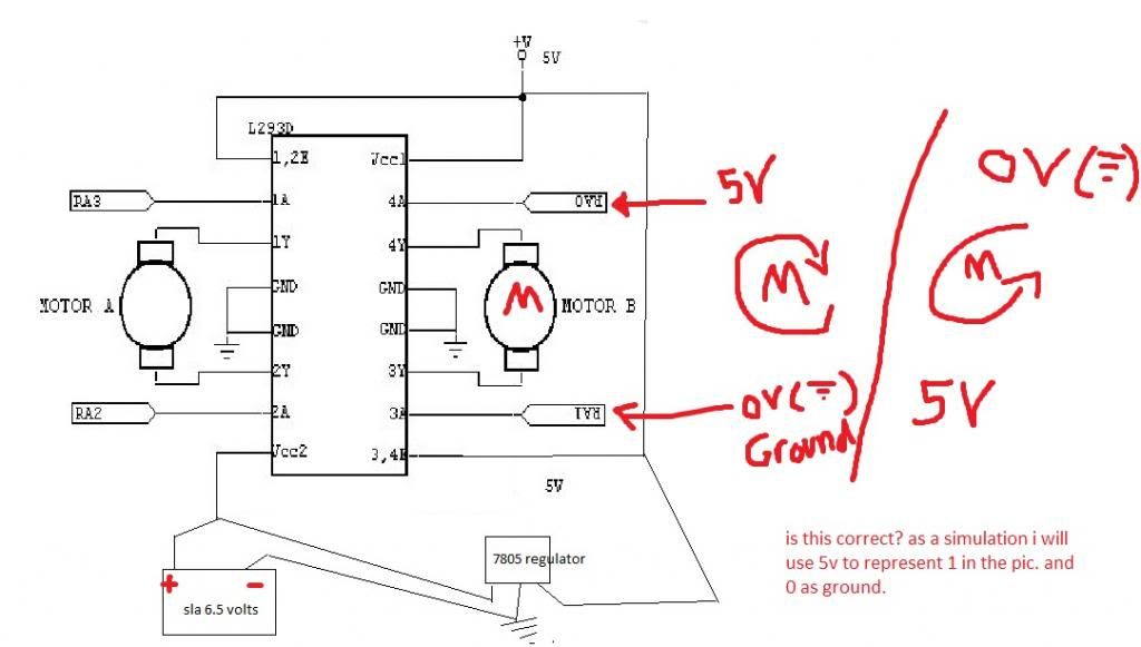

i dont know, i cant understand the diagrams i searched.
check out what ive done. can this thing work? since my hbridge is expensive and very hard to find availablitiy , i dont want to mess it up.
any corrections?.

That's correct, but you can increase the actuall Vcc voltage to 5 - 12V. Keep the enable at 5V thou. That chip can also do PWM.

http://arduino.cc/en/uploads/Main/arduino_MotorShield_Rev3-schematic.pdf
You can ignore the current-sense amplifier.

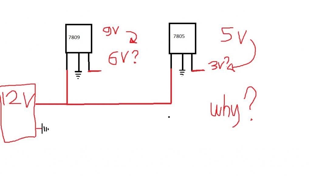

thanks for all help. the hbridge chip is now working.
this maybe an out of topic question. pls answer
i have a 12v battery source. the regulator is in parallel. the 7809 suppose to regulate 9v. and the 7805 is 5v.
when i test them. the 7809 output has only 6v and the other is only 3v. why did this happen?
do i need to get them in series?

Not enought current maybe. If you take one of them off, does it output the correct voltage?
