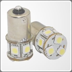

int Light1 = A10; //Will control 1156 Leds inside. or maybe i need digital pin.
int Light2 = A11; //Will control 1156 Leds inside. and might need some relays.
int Light3 = A12; //Will control 1156 Leds inside. oh shit, what did i get myself into?
int Light4 = A13; //Will control 1156 Leds outside.
