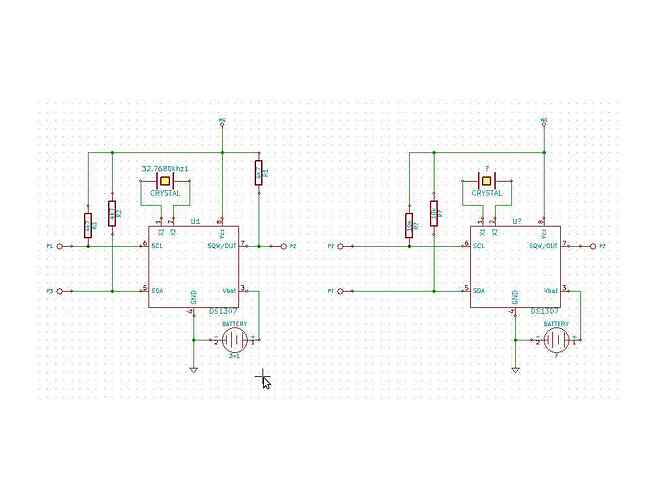

Hello guys,
I have a serious issue here. I have a signal (5V)  as shown
If I zoom to 5ns/div, then we can see some tiny noises between 4.9V and 5.0V or so as shown
Note that these pictures are given when I connect the signal to an oscilloscope.
Now the interesting part!
If I connect this signal to the digital port and load the example sketch DigitalReadSignal (File>Examples>01.Basics>DigitalReadSignal), then I get a series of zeroes and ones as the output (Actual Output: 1 0 0 0 1 1 1 0 0 0 0 0 1 1 1 0 0 0 1 1 0 0 0 1 0 1). Founding this bizarre, I connected the signal to the analog port and then I loaded the arduinoscope sketch. I got the following result
Now if I use the 5V line from the arduino, then I get the correct 5V reading on the serial monitor. The same goes for GND. But when I connect my signal, everything is a total mess in the arduino!!!
What code? What is generating this signal? Did you connect the grounds, too?
I don't find the output bizarre, if you didn't connect the grounds, or set the pin mode correctly, or a number of other possible problems.

I'd also vote for a lack of common grounds - you don't have a circuit if you don't connect ground as well, a circuit needs two wires.
When you connect only one wire you are using one circuit as an antenna for the other.  Typically you will pick up mains interference.

It also looks like you are trying tool okay a signal too fast for your scope, or at least the settings you have on the scope.

I checked the grounds again and it is brilliantly working now.
Thanks for the help!!!
I was thinking along that line at first. I used a better scope after and nothing changed.
It was a ground issue after all.
Thanks for reminding about the speed of scopes.
