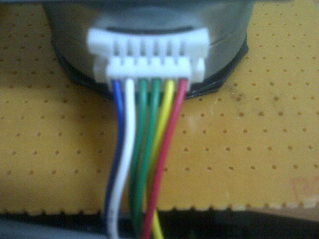

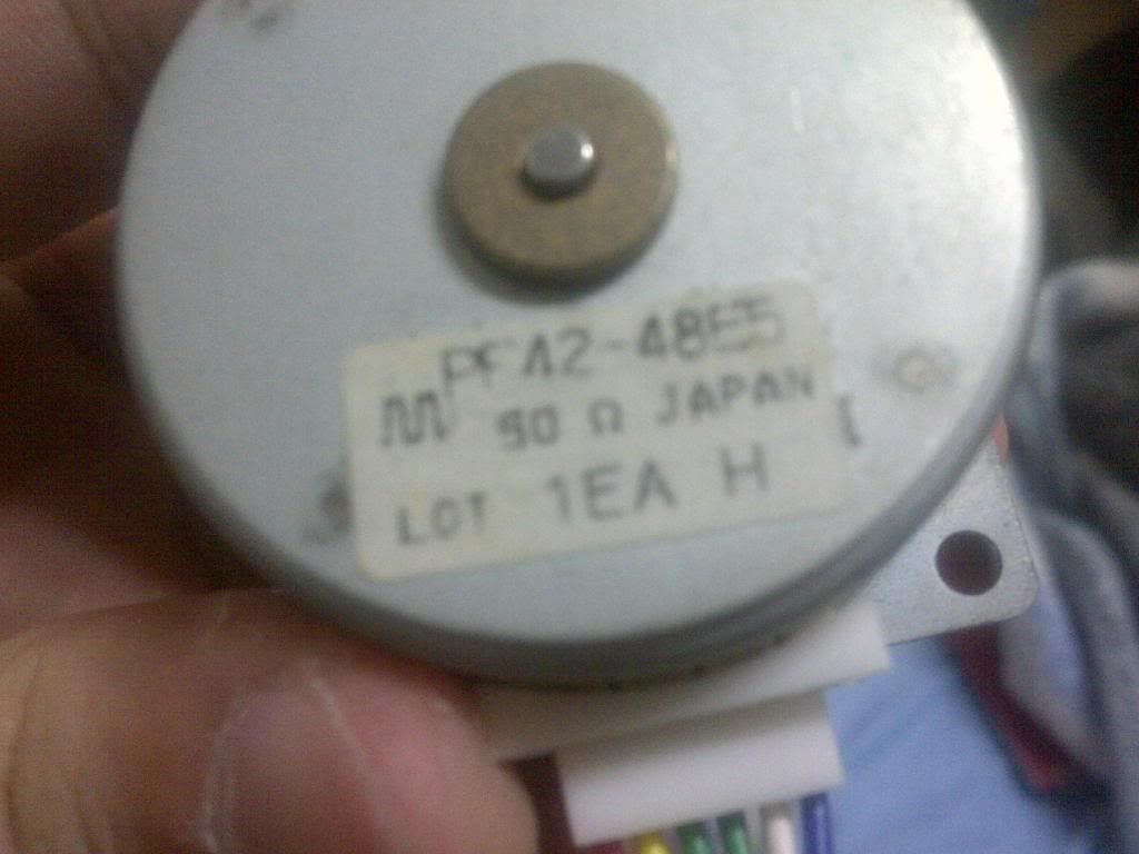

I have this kind of stepper motor
the type is PF42-48E5
and here is the data sheet: www.jameco.com/Jameco/Products/ProdDS/171601.pdf
I do not know how to connect this pin, which one is ground, vcc, data, and why so many colouuur???
Any heeelp?

Measure the resistance between each wire to determine the coil setup.
It might be the 2 green wires are commons to the other wires,
If so they would then be connected together, see Jason2548 link.

http://www.nipponpulse.com/catalog/document/4b16d0783ef33_PF(C)_Unipolar_Wiring.pdf
Ok look at this one. It is for unipolar two phase motor.  I have two of this motors sitting in front of me and I looks to be the same wiring just different colors.  instead of green i have reds in the middle.

The Green wires are going to be Voltage supply and then the other four are the four seperate coils.
