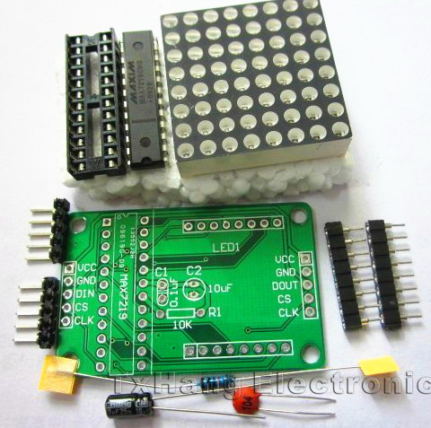

been looking for tutorials on this - (i just finished soldering it altogether and i want to use it),but none really to be found..
thanks in advance

k,, ty.. but also looking how to hook up the outer pins to the arduino..

Never used one but from the code, I saw this:
Code:
int dataIn = 2;
int load = 3;
int clock = 4;
and on the left of your picture are the connections:
DIN
CS
CLK
so I think they match up like this:
Code:
int dataIn = 2; //DIN
int load = 3; //CS
int clock = 4; //CLK
Logged

but there are 10 pins.. only 3 to make this work?
Looks that way. Check out the link to the tutorial in the code that pyro_65 linked to. It'll be 5 of course though since you'll need vcc and ground.

3 are already mentioned. The other 2 are Gnd and Vcc, not much imagination required here.
The other 5 pins are the same and they are the output side (DOUT is the opposite of DIN). These modules can be daisy chained. If you wanted to add the second or more modules you connect the 'output' of one board to the 'input' of another.

code doesn't work..

this code works.. just need to switch pins on the arduino to 8,9 and 10
Code:

trying to make sense of it..
you can the code here: http://www.linksprite.com/download/showdownload.php?lang=en&id=223
or
here (takes you to the same exact same place): http://www.linksprite.com/upload/file/1347631413.txt
They're bit patterns, for your dot-matrix display.
Eight bytes per character, each byte with eight bits.
At the moment, they're consuming precious RAM - they might be better placed in PROGMEM.
