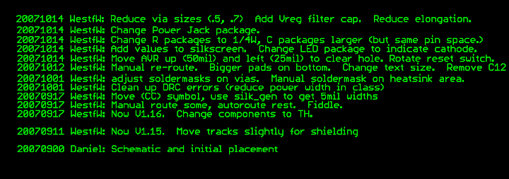

The problem with traditional version control for HW CAD files is that there's no easy equivalent of "diff" to see what the differences are between two checked in versions of a file (or between your currently checked out working version and the last checked in version.)  You're at the mercy of this being adequately described manually, or being able to look at two versions "wholistically" and tell what's different.  In theory, there are a couple of things that ought to be helpfully diff-like: EAGLE (and other can programs) can export scripts that describe the design in text format, which IS diff-able.  The check EAGLE does between board and schematic to see if they are consistent might be helpful when run with "old schematic" and "new board" (or vis versa) renamed to the same prefix.  EAGLE could easily output a "text" version of a board/schematic listing component, coordinate, etc, in a way that might yield useful comparisons with diff.
Meanwhile, I've been reverting to ancient practices that predate most version control software.  I've defined a new layer "Edit History" that I put text on whenever I do something significant.  Hopefully.  For instance, the Edit  history of the through-hole "Freeduino" board looks like this:
(The gaps represent significant editing in other versions.  ie, Daniel entered the schematic with SMT parts defined, and there was some work done, terminating with "V1.15", then everything was converted to TH parts and now-irrelevant (?) parts of the edit history were deleted.)  The tough part is figuring out when you've done something that really needs an entry in the history.  (Periodically, the version changes a  new file gets written, giving me the simplistic backup capability.)
