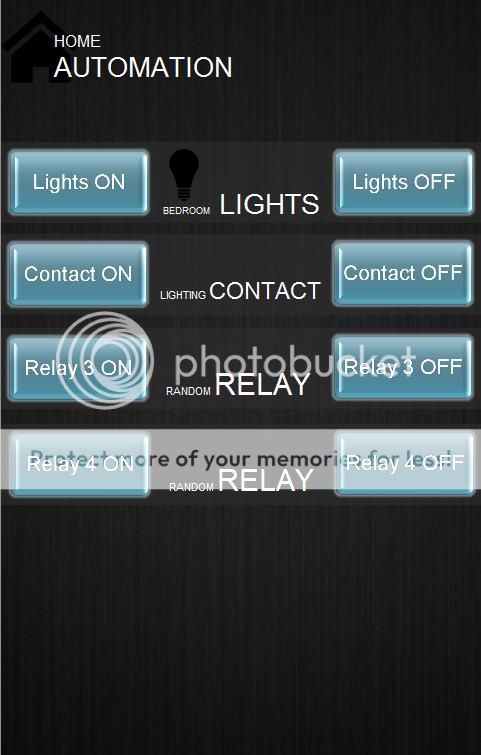

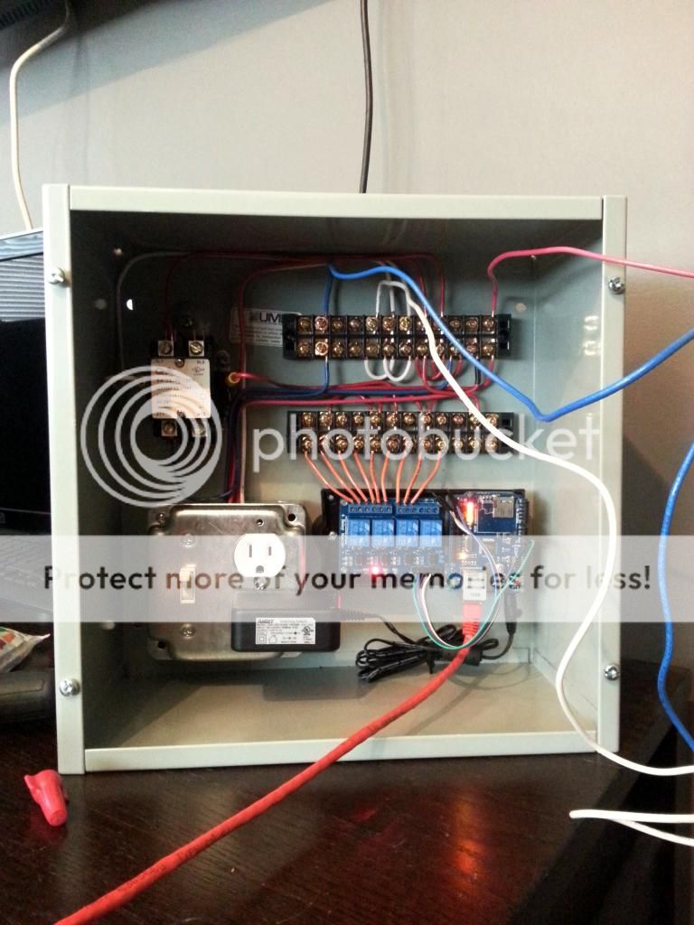

hi, I was just introduced to the Arduino systems this past November. My first project consist of an UNO board, paired with an ethernet shield along with a 4 channel relay board. Additionally, i made a simple Android app to accommodate my setup. As a newcomer, I would gladly help any other newcomer who are trying to build a home automation system. Here are some pics of my setup. What do you guys think?

inside the transmitter box
veseo
Nice work, but (if you haven't) ground your case otherwise you want be safe in case of faults.
