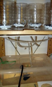

Hello everyone!
I have recently received the stater kit from Adafruit and started tinkering with the Arduino :
For my "HydroDuino" (automated hydroponics using the arduino) project
-i am currently trying to control a 5-12V water pump (basic on /off ) using one digital pin
-i need very precise timing in order to avoid overflow : this part works very well (tested with a simple led)
-i am not really good at electronics but after looking around i decided to go with a tip 120 transistor (with a diode for security) (schematics found here http://ctheds.wordpress.com/2007/10/30/tip-120/for example
More info etc in my blog http://www.kaosat.net/?tag=hydroduino
THE PROBLEM:
   * i am having HUGE speed fluctuations in the pump, so each and every time i start the system, i get different speeds, which pretty much defeats the whole "precise timing for a precise filling".
   *o in a lot of cases the motor starts of veeery slowly, and the speedup rate to an acceptable level always varies
      o sometimes about halfway through the timing interval (set at 180 seconds for now), i will get a sudden decrease in power : my guess is this is tied to the tip120 transistor, and the lack of sufficient "differential" :  i managed to reduce this problem somewhat by exchanging the 1k transistor that goes to the base from the Arduino digital pin with a lower rated resistor
   * these problems are unlikely to come directly from the pump as i did not have such fluctuation when running it directly on the power supply
   * i am also aware that using a cheap 8$ pump which eats up 2.2A at 5v (twice what was indicated on the seller's site) is also begging for problems
   * I am not really good at electronics, but from what i gathered, i might need to add a few capacitors to smooth out the current and reduce the spikes?. like here ? http://www.tigoe.net/pcomp/code/category/Picbasic%20Pro/62
Sorry for my obvious lack of mastery in this field, but i am more than willing to learn :)
Any help , comment or suggestions is appreciated!
Thanks in advance

ckaos
Wow, thank you all for the very quick replies!

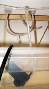

I guess i really wasn't clear enough about the project itself:
-This will control the water flow in a homemade ebb & flow irrigation system: basically the water is being pushed up through the BOTTOM of the bottles at set intervals per day.
-Once the set level in the bottles have been reached , the pump shuts of and releases the water BACK into the container.
more on it here :http://www.hhydro.com/cgi-bin/hhydro/ebbFAQ.html
-some picture for more clarity (on these photos i only linked up two bottles but normally it's four)
bigger versions just in case :
http://www.kaosat.net/wordpress/wp-content/uploads/2009/03/ebbflow00-closeup.jpg
http://www.kaosat.net/wordpress/wp-content/uploads/2009/03/ebbflow00-closeup3.jpg
Grumpy_Mike:
-thanks for that link, i have read it but i will do so a couple more time to understand all the concepts:)
-well i am running it at a lower voltage : normally it is a 6-12v pump, but i tried it at 12v and not only is it way too fast , but it also almost fried the tip120
-to get the Amperage i measure the resistance of the motor (when not running it is about 2.2 ohms), and then i divide the actual voltage used by the resistance
-yes sorry about that it is a lower valued resistor :100 ohms
-i will take a look at the Darlington pair thanks for that :)
-i am not really sure what way i would have to measure the water flow, as the tubings are 1/4" ...hmm although, now that i think of it i could perhaps calculate the flow based on the elapsed time between two set level of water..i will study this !

-the float switch would unfortunately be very impractical in this case (see pics)

I don't mean to undermine folks assistance, but after reading a little on the link you provided and studying your pictures, I don't think you need to sense the water level at all.  Since each jar is its own space, which is open on the top, and you only have one pump, flow and level sensing won't be very accurate.  If you had a pump for each jar, you could do that.  What you need is an overflow drain at the top of each of your jars that will allow extra solution to drain away if a jar fills before the others.  The overflow drains should flow faster than the pump can fill the jars.  Depending on how powerful the pump is, you might start at about twice the ID of the fill hoses.  So if the fill hoses were 1/4" ID, then the drain hoses would be 1/2" ID.  You'll need to experiment to find the best size.
Then you only need to work out the timing between fills and how long to run the pump each time.
EDIT: Actually a float won't work even if you did have separate pumps because the growing medium would not provide any free water volume to float on.
