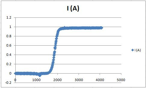

I concur that measuring distance with the proposed method will not work.
An idea which I had is the following, which might give you the desired effect:
Instead of firing 1 packet, fire several, each with a different damage coefficient. Now send each of the packets with a different current through your led. The higher the current, the longer the reach.
Current can be controlled through a DAC-controlled mosfet, in between closed and open the mosfet has a part where it opens slowly as a function of voltage.
Another way to achieve this is to connect several resistors to your IR led, each chosen to give the desired current, and use transistors to switch to the preferred resistor.
Trial and error will learn the reach of each resistor setup. Then you will have to program you code on the receiving end so if it receives multiple correct packets from the same player in a short amount of time, only the highest damage coefficient will be used.
Voila.
Now: my tagger runs at 600 rpm fine, this works at the receiving end as well. I am not sure whether 1800 rpm (3 shot packets per shot) is feasible, but you would have to try. My taggers are btw standard equipped with 300 RPM, so 600 RPM will be rapid fire.
Cheers
Jack
