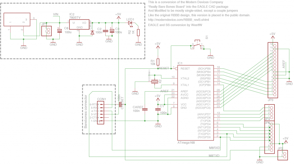

I made a barebones board using a Atmega 328P that I installed the bootloader on using the instructions on Nick Gammon's site. I tried this Atmega on an Arduino Uno and loaded an example sketch; it worked fine. With the Atmega back on the barebones board I'm having trouble loading a sketch; getting the error 'avrdude: stk500_getsync(): not in sync: resp=0x00'. I'm using an ftdi breakout board like thishttp://www.trossenrobotics.com/p/FTDI-Basic-Breakout-5V.aspx?feed=Froogle&gclid=CL-NupmvqrUCFUXf4Aod_B4AEQ. I have used this breakout successfully in a project that uses an Atmega 328 that I also loaded the bootloader on.
When the USB cable is plugged into my computer, Windows recognizes it as USB Serial Port(COM18) and the transmit and receive leds on the breakout briefly blink. When the upload is attempted, the the TX led on the FTDI breakout blinks 2 or 3 times. I've tried selecting various boards in the IDE and I've also tried adding 1k pullup resistors to the RX and TX pins of the Atmega and I've tried various methods of pressing the reset button on the barebones board. I've also tried switching the TX and RX pins on the barebones board. All the things I've tried were suggested by posters on various forums having the same problem.
Below are images of the barebones board and the schematic.
Any ideas of what else to try? Thanks - Scotty

Your layout does not appear to have anything connected to pins 5 & 6 where Rx & Tx are.
Is there a 2nd side to your board that is not shown?

Forgive me guys for neglecting to include the top layer of the board which is really only two jumper wires. One from pin 5(RX) of the FTDI to pin 3 of the Atmega and the other from pin 4(TX) of the FTDI to pin 2 of the Atmega.

Something wrong with the DTR auto-reset signal or wiring. You can test that by doing a well timed manual reset when you try and upload. Press and hold reset down, then hit upload on the IDE and when you see the compiled sketch size printed on the IDE release the reset switch.
Another possibility is that you have the tx/rec signals from the USB serial converter and the 328p rec and tx pins crossed.

This isn't making sense. Gotta be something stupid. Lefty, I did try the reset method with the TX/RX one way then the other. I removed the 1k pullups resistors on the TR & RX pins and tried all that stuff again. I inserted a known good Atmega 328 and still get the same message. Have to think of something else to try. Thanks All, for your input. - Scotty
scottyjr
And indeed it was something stupid. How come none of you guys told me I neglected to install the resonator? Sorry to waste your time. - Scotty
