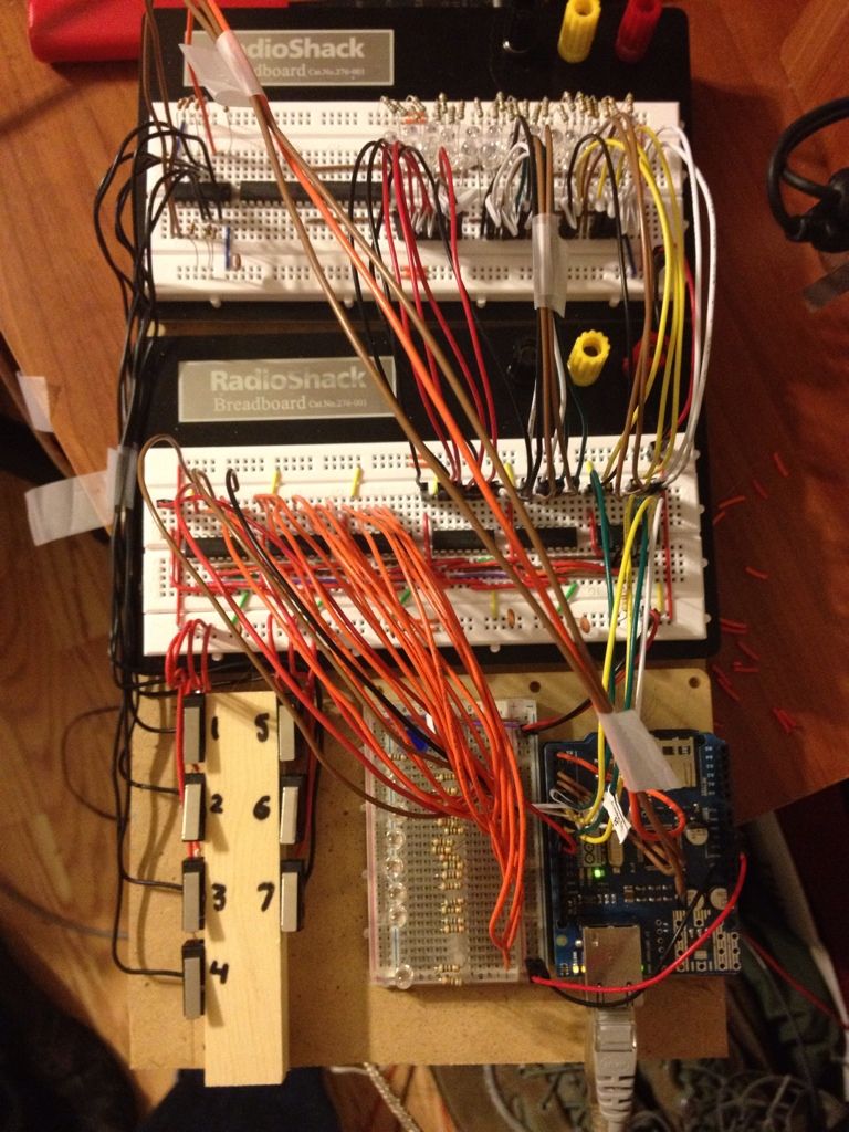

Hello again everybody!
I have 6 74HC595 Shift Registers daisy chained...  Is that too many?  It seems to be acting screwy.  By "screwy" I mean it is not lighting the LEDs I would expect, when I would expect it to do so.  Perhaps I am missing something code-wise?  I have tested and verified the chips and connections individually, and all is well.  Additionally, when the arduino 1st loads I have noticed that the intended LEDs flicker for a split second, then never come on again.  OR after a reset the intended LEDs will come on if they are in registers 4, 5, or 6- but then they just stay on ignoring the ender(); function altogether.

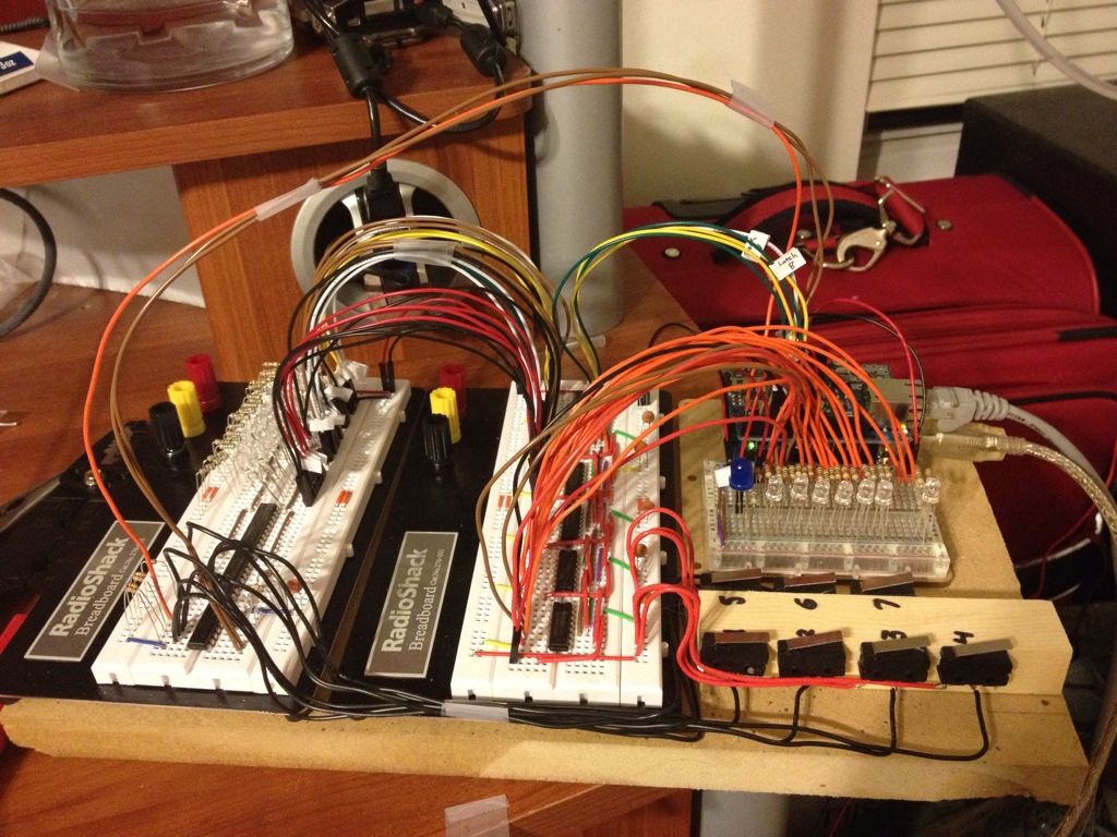

Also, as noted above, I have decoupling 0.1uF capacitors plugged in just before each registers Vcc in.  The caps are bridging Vcc and Gnd.
Here are a few pic of the full setup- it's difficult to see exactly what my wiring is doing in a picture, but I think the BarBot is getting pretty awesome!
The LEDs on the far left are standing in for three transistor array chips.  I had to remove the chips once I discovered the shift registers acting funny- I put the LEDs in for ease of troubleshooting for now.  The LEDs you see on the far right are RGB LEDs- they will be for effect lighting in the finished project.  The switches will sit in the glass holsters to let the BarBot know if a glass is in place.  That way it won't just pour booze on the counter  smiley-eek  In addition, if there is more than one shot glass present it will turn the wheel to the next present glass and repeat the recipe- up to five shots at a time!

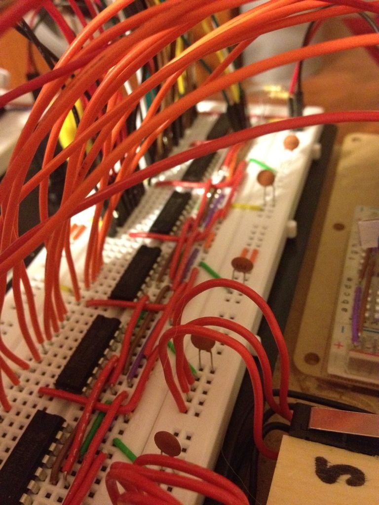

Here is a close up shot so you can see (kinda) where I have my decoupling caps.  The green leads (or in the case of register #1 and #3, yellow) right next to the caps are going to the chip's Vcc line.

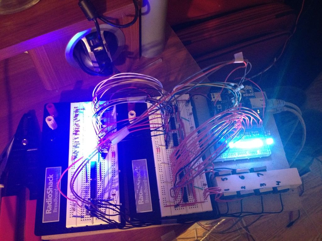

Proof that when passed
Code:
      digitalWrite(latch, 0);
  shiftOut(data, clock, MSBFIRST, 255);
      digitalWrite(latch, 1);
All registers WILL work, but as stated before, not as expected. For example- this code WILL light all the register's LEDs, but not at first...  it first lights the last five registers, then a minute later the first will light up.  Also, if I then pass it

Anyways, here is the proof that the shift register WILL light everything up when passed the code above- so they ARE wired correctly enough to address all their outputs at least...

Since you're not showing a schematic, and the code looks ok, I would suggest moving the decoupling caps closer - like the hole right next to the vcc pin in the same row, not way off to the side where you have them now.

Long, unshielded, leads everywhere. Let's see if we can pick-up/generate as much Noise/RFI as we can. ;-) hint hint.

I fixed it.
First I moved the caps much closer to the Vcc pins, and even shortened their leads since I read that is advisable.
That didn't fix it (although I'm sure it's good practice) but while doing it I noticed that when the arduino is reset, when it comes back online it shifts the last bit that it was given out to the registers.
This got me thinking...  the problem must be with my latch!  The fact that it shifts the last bit it had out means that the data and clock pins are doing what they should, but latch sure as hell isn't!
I started my 8th check of my connections, but this time I put special emphasis on checking the signal chain of latch- and I found it.
on the very last (6th) register, output enable was accidentally tied to latch  smiley-small
Apparently it just slipped into the wrong row as they are adjacent, and it can be difficult to see if you are not looking exactly for it.
I re-routed the OE to the row it should be in, and all is well again.  Thank you to all who helped me find it- as by examining my code and telling me it wasn't the issue, and by letting me know that 6 shift registers are NOT too many, you got my mind focusing on the real problem.

I'm glad you got it working. Looking at your original photos, the most obvious problem to me is that each of your decoupling caps has quote a short path to the Vcc pin of the adjacent shift register but a *very* long path to the ground pin of that shift register. My suggestion would have been to add a short wire from each shift register ground pin to the ground side of the adjacent decoupling capacitor.
