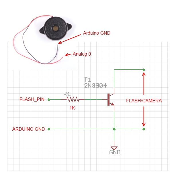

I have just finished a small project -- sound trigger. It is very stable yet very sensitive -- it can detect a moderate finger  snap 3-4 ft away.
Schematics and construction:

Very cool! What sort of microphone/speaker was that? I was trying to detect the tick of a grandfather clock with only partial success.
You could use the analog comparator instead of analogRead, that might give slightly faster response (not that it probably matters):

Oh, it is a piezo type of buzzer which can also be used as sound (pressure) sensor -- it generates voltage under pressure or sound.

Very cool project you have there, too. I am new to Arduino world, but I'd love to use the comparator mode for this. Or even do a lightning/thunder trigger. Thanks for the tip.

Actually, I put in a photo diode in with positive terminal going into A0 and negative terminal going into Gnd on the Arduino, it can detect a Yongnuo 560 at 1/128 power level 15 ft away -- not pointing at the flash, but pointing at the ceiling. I am sure if pointing to the light, it can detect it at even further distance.
The photodiode is BPW21R
So, it should be good to detect lightning.

I am having a problem with this circuit. I can detect noise and see the serial monitor respond, however the flash will only fire when I remove a wire and from the circuit. Does this possibly have with the fact that I am using a disposable camera flash unit. Any help is appreciated.
