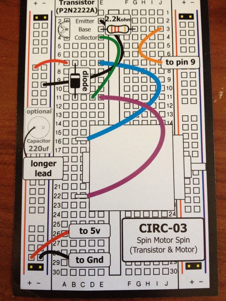

Sure!
Here is a little schematic I found using a transistor and a DC motor.  It uses a transistor that does not have it's own internal diode, which is why it is in the schematic.  This is the same way I started wiring my pumps before I bought transistor arrays (chips with 8 transistors + diodes)
Be sure to check the datasheet of your transistor, because your emitter and collector may be on opposite leads as this schematic, and it may even have it's own diode.
