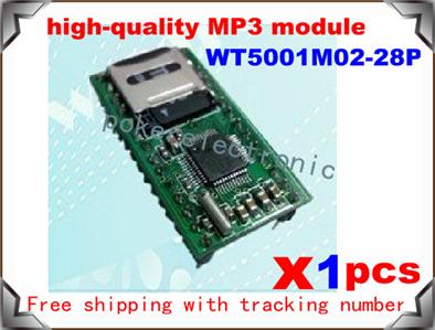

someone have tested this sound module with arduino?
i just ordered one
it uses WT5001 IC
it supports micro-sd cards and it can play also wav files (that i prefer than mp3, because of lag at begin of each track)

today i received the module
while plays mp3 files without problem and with a very good quality, i can't play wav files
tested 8bit 80kbps 22khz without success smiley-sad
something odd: if you want to keep the files order, firse must create the mp3 playlist on hard disk (0001.mp3, 0002.mp3, ecc) and when ready copy to the micro-SD card. If you rename on microsd card it will messy the order.
I used 2 watt stereo speakers @ 8ohm: if used in mono no problem, when stereo you can hear clipping. With a mini amplifier no problem at all also in stereo mode.

Great! I read the manual and was not that clear how to connect it or program it. Do you have a new manual or just were lucky connecting it?
i just followed the data sheet
http://www.hmangas.com/Electronica/Datasheets/Modulos%20de%20Audio%20y%20MP3/WT5001M02-28P/WT5001.pdf
there is the WT5001M02-28P pin assignment scheme (page n. 10). On the board the first pin on the left is labeled "1" as you can see on the magnified picture.
The 5v input is the vdd50 pin 22.
From pag. 14 you can find the serial commands to use with arduino.
