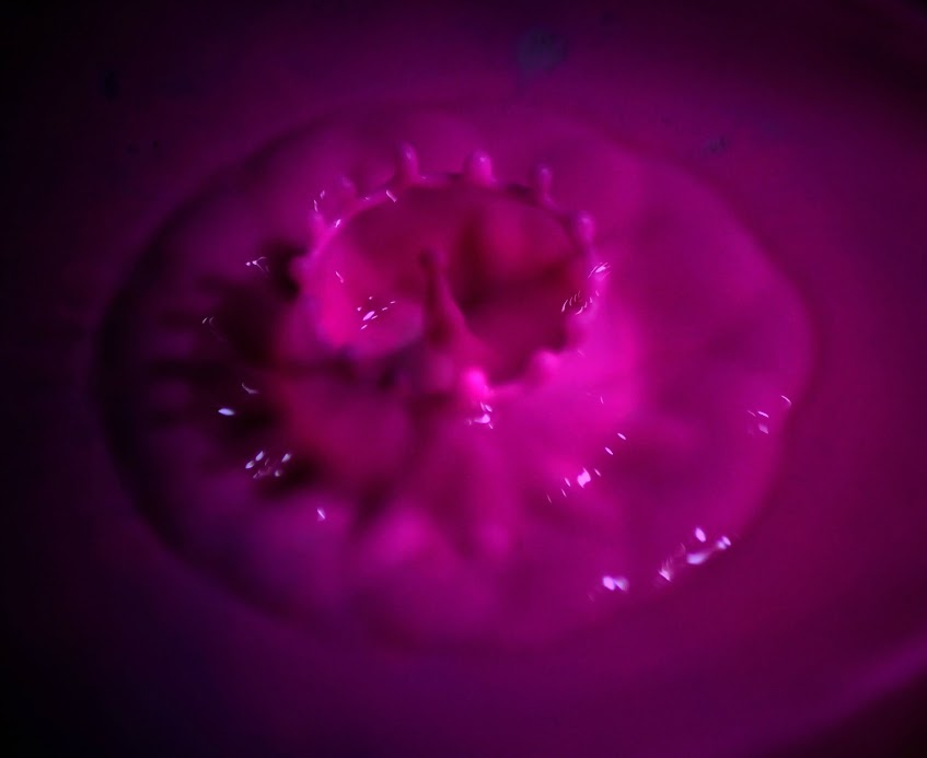

Using a IR pair as a photogate, arduino for the timing, and a bunch of cheap MOSFET's, I drive literally hundreds of watts of LED's for stop-motion.  This particular one is three consecutive 2msec flashes 5 msec apart lit with about 75 watts of LED's, a paint drop landing in a bowl.  I have to revisit that project, I have now amassed just about six hundred watts of white LEDs and built drivers.. and much more efficient and fast switching transistors for them too.  I should be able to dump around 45,000 lumens at intervals down to microseconds with ease.  Since I am just letting the LEDs power up to flash, the cycle time is nonexistant.  Arbitrary delay, duration and interval strobe, solid state. This was shot badly, mainly because I tried to use a relatively slow ISO with a wide aperture - which backfired in terms of having too shallow a depth of field.  That, and 2 msec introduced more blur than I want.  More power and better exposure planning will make for a much better outcome- but suffice to say, using power LED's as a photostrobe is more than feasible.
Tons of light is the key with stroboscopic effects...
