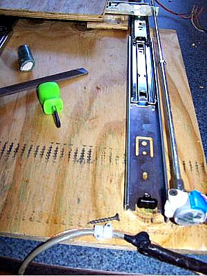

My XY table made with Home Depot ball-bearing kitchen drawer slides, two dollar steppers, and threaded rod.  Made for about twenty dollars.  Now admittedly this is a total hackjob, but the design works.  Those steppers are actually geared down to over 2000 steps per rotation, with one rotation moving the carriage a tiny amount.
Make a slightly beefier version, less epoxy and better steppers, and you will be in business. 1mm resolution shouldn't be TOO hard to achieve.  This has been sitting on a shelf waiting to add a third axis and be a CNC router for a few months..the whole project is supposed to be making a CNC router for under $100...

Terry-  Yep, it's those AirConditioner steppers.  Love them, so much torque it's crazy.  I've not ordered from your store, but have browsed a number of times and seen you carry them along with the ULN2003A darlington driver boards for a couple of bucks.  Great item, everyone should have a handful of them.  I have also mounted wheels on two and a caster for a third wheel and made a bot with them, and if you remember my Frankenbotic Thinganator (the wall plotter made of salvaged stepper motors and fishing line) I went back and replaced the original steppers with those little beasts, but I haven't redone the code yet.  Suffice to say, the resolution on the Thinganator is going through the roof... the video below is the original Thinganator, somewhere around here I have a couple of photos of it writing "Arduino Rocks" in a couple of fonts.  Taking out radial distortion was very hard and done with recursive approximation.. the new version will implement some newer, faster code which is based on Heron's extrapolation of Pythagorean theory, calculation of the height of a triangle (y coordinate) by the length of the sides/tensors (my fishing lines form two sides and the beam is the third) and then calculating the x coordinate from the y.  It actually made sense once I started thinking of it as a tensor/triangle problem-- the inverted triangle, no matter the angles, is composed of two right triangles of equal height, gravity being the third tensor.  MUCH more accurate and fast than recursive approximation.  I've also been thinking about a tweak to Bresenham's line algorithm (which I already redid for this as unidirectional while Bresenham's is arbitrary) that ought to make location calculation a bit easier too, but that's for another time...
http://www.youtube.com/watch?v=puoAsZ_kQD0
As for coupling on the XY table, that's a 1" coupling nut, filled in with epoxy and jammed onto the motor halfmoon shaft, then caked in more (stick this time, not liquid) epoxy and secured with drywall screws.  If my projects don't give actual engineers the heebie jeebies, then they obviously haven't looked too closely.

@focalist: Motivating to read up on your project. I think I'll try that from-scratch approach -- I'm very new to the whole linear-rails-stepper-motors world, but if you were able to do it with a few tens of dollars, I suppose I have nothing to lose by giving it a shot.
For a crude first-draft, would you say this covers the shopping list?:
--slides (e.g., kitchen-drawer-type)
--threaded rods
--one stepper motor for each threaded-rod/direction
--nails/screws to set everything stable
focalist
Sounds like a good shopping list.
Despite mine and Terry's comments, those little steppers are not really suited to the job very well.  They are made to turn vanes on air conditioners and stuff like that and are not that robustly built.  They are made amazingly well for two dollars.. but they are two dollar motors!
Happily, steppers are not really expensive and you don't need anything with immense torque or speed.  You should be able to get away with any "standard" stepper.  Here's one that was one of the first hits on an ebay search..
http://www.ebay.com/itm/Lot-of-5-Stepper-motors-NEMA-17-DIY-CNC-ROUTER-MILL-ROBOT-REPRAP-MAKERBOT-Prusa-/111005363513?pt=LH_DefaultDomain_0&hash=item19d86f6d39
That's five NEMA17's for $43, pretty good deal.  You are just looking for something similar to these, exact ones don't really matter all that much.
The drawer slides really do make amazingly stable rails for what they are.  Use two per axis, spaced as far apart as possible, that'll keep the wiggle to a minimum.
The key for you is going to be keeping that wiggle factor to a minimum.  As for movement, if I remember right, the 1/4" rod is 12 thread per inch as a standard.. which means it will take 12 turns to move the carriage one inch.  Those ones above are 1.8 degrees per step, 200 steps per revolution.. so that's 2400 steps per inch.  WAY smaller than a millimeter.  The thing is, the construction method and "play" obviously makes a difference.  Even if you get this down to only 100 steps per inch of movement, 1/24th of the stepper/rail movement accuracy, you should be reasonably good to go.
Buckets of epoxy, sticks of it, and have hotmelt handy too.  You are going to want it!

For removing slop, this methodthis should work for any threaded rod. - Scotty
focalist
Very cool with the DIY nut.. two things come to mind.  One is that you could probably well-oil the rod and then form the "nut" out of Hotmelt glue, doing essentially the same thing as HDPE (might even be HDPE for all I know) except not having to do all that clamping and such.  Epoxy grabs pretty tight and is more brittle usually, but "pouring" hotmelt into an impromptu mold would be simple.
The other is to mention to the original poster that since his build is rather small- larger than a disk drive size but not big ole CNC router either- he could very likely harvest the carriage assembly from a printer or scanner.  They tend to be really quite good.. attach a drive screw and you are good to go.
Which brings me to the last idea:  many printers and scanners have both a very solid rail system and a drive method which is often a stepper motor.  It may be worth it to just hack the whole assembly, and use the existing stepper motor.  Printers tend to belt-driven, so the delivered torque might not be as high as a leadscrew-- but he may not any real torque for what he is doing..
