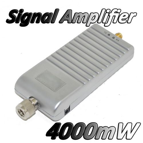

TrailerTrash
i have this on my wish list to replace my 2W.
High Power 4W 2.4Ghz Wifi b/g/n booster Amplifier for Router AP Wifi Adapter
http://www.ebay.com/itm/310502802694
