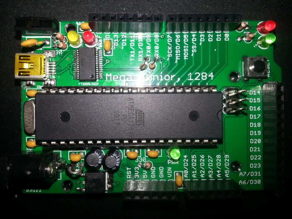

Hello Everyone,
For a bunch of long winded reasons I've really been enjoying the 1284 as an Arduino lately. Because of this I've decided to design 3 different Arduino compatible devices based on the 1284.
The first two "Mega Junior, 1284" and "Mega Junior, 1284 SMD" are the same layout as the UNO, and both have the FT232RL chip onboard.
The "Mega Junior, 1284" has a socket for a removable chip in 40 pin DIP format and the circuitry is laid out to maintain compatibility to the pinout of the Sanguino, and maniacbugs mighty 1284. (Hope I got that right).
The "Mega junior, 1284 SMD" uses the 44pin QFP version of the 1284 and is completely custom in the way of pinout and is designed to be as compatible as possible with the Arduino uno pin locations. For the initial revision of this board I've chosen to keep programming pins and interrupts in the proper location at the sacrifice of two properly placed pwm ports.
The "Mega Junior, 1284 BB" is designed as a breadboard model and also has onboard FT232RL and all the other features one might expect of an arduino.
In addition to the boards I will be maintaining repository for all source designs and a easy to install version of optiboot which will include firmwares for 8,16, and 20mhz for my 3 boards, AND all of the other common boards of utilizing the 1284. This project is of course open source, and I'm doing this to share with the community what I've done for myself.
The only board currently tested is the "Mega Junior, 1284".
If your interested in one and dont want to build your own, send me a PM and I might be able to get one built for you, I'll try to keep a few spare boards on hand.

Mega Junior, 1284 V2
Features:
On board FT232RL usb-to-serial.
Mostly PTH components.
99% shield compatible (No PWM on D3 & D11)
8,16, or 20Mhz firmware available.
Jumper disconnect for i2c pullup resistors
Jumper disconnect for DTR/RESET
Jumper disconnect for D13 led
DPDT switch for Analog / I2C selection @ A4 & A5 pin location
Arduino Diecimila style switch for USB/EXT power.
Mega Junior,1284.
Board can be purchased from BatchPCB here: https://batchpcb.com/pcbs/110133
Features:
Compatible pinout to Maniacbug's Mighty 1284.

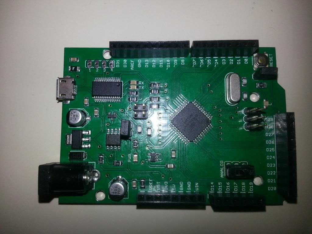

Features:
Mostly SMD components.
Auto switch between usb and ext power
Schematic and board layouts attached.

westfw
Nice job fitting all the parts in a form-factor close to the original Arduino!
retrolefty
Great AVR chip, great idea to make it more easily available for users.
CrossRoads done a similar through hole 1284P based board and he sells the bare PCB.
So you going to pub a schematic so we can compare it to Bob's rendition?
How are you handling the +5vdc switch over from USB to external power?
No way to map the I2C pins to A4 and A5 for 328P based shield compatibility? That's a real
pain for mega boards.
Which bootloader are you going to use?
Lefty
Thanks!
Eagle Files will be made available inside this thread, this will be the main project thread, it's in it's infancy at this point.
Once fully tested I will also include a link to the board(s) @ batch PCB so you can buy a tested known working board directly from them and build your own Mega Junior, 1284.
The Mega Junior, 1284 is mostly all PTH and trying to stay as close to the Arduino form factor it was nearly impossible to fit the auto switching circuit. Similar to the Arduino Diecimila there is an on board swith (top left) to switch between USB/EXT power.
Originally this started out for me only before I decided to share it, Later on I may release a new revision of this board that will conform more to the R3 form factor. I did take this into account with the Mega Junior, 1284 SMD but forgot the ref voltage pin (doh!) This will be fixed in later revisions.
If there is enough of a demand from the community I will do something to move over the I2c, but you will loose analog on those ports, unless I jumper or something along those lines.
I'm using the latest optiboot, when available I will try to include firmwares for all other known 1284 boards to make it an easy to install one-stop=shop package for all. I've tested firmwares for 8MHz (internal clock), 16MHz & 20MHz external crystals.
