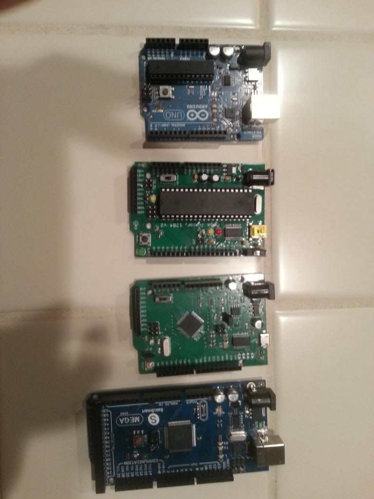

I'm a big fan of the 1284 as I'm using it on a my custom boards for electronic props for compat games.
I like the idea of an Uno or Mega compatible footprint, although most people using 1284 are probably at a stage where they'd be designing a board, or using something like Crossroads Bobuino board. Still, it's a good idea as another option for people into this nice little MCU with the extra resources that will satisfy many larger projects.
I notice that SPI and UART are on incompatible pins than Uno. The Bobuino pinmapping makes these compatible, RXT/TXD on D0/D1 and SPI on D10-D13. You have SPI on D4-D7 and RX0/RX1 on D8/D9.
Surely a standard shield won't work with your pins as is? An SPI shield may do, if it uses the SPI header, rather than pins 10-13, although I believe the Ethernet shield uses Pin 10 for its SS, whereas you have SPI on D4-D7

Please read the 1st post. The board that has been "released" was originally designed to be compatible with the bootloader and pins file from the mighty 1284, the concern was putting data pins in the right locations not any of the secondary (depending on your perspective) functions. The SMD board is much much different and conforms as tightly to arduino spec as I could. But an excellent observation none the less... Thanks!

hmm so it is, sorry about that. I'm at work now give me a few hours and I'll upload the revision A schematic along with the new version 2.0 dip version and revision b of the SMD version. Now both include jumpers for I2c pullup, disconnect jumper for the d13 led, disconnect jumper for DTR/RESET, and jumpers to switch between analog and i2c for better compatibility.

V2 and SMD rev b tested and good to go. I have 4 extra of each right now if anyone want's one. Asking $60 plus shipping which covers my cost on parts.
Below is a reference picture for size, both V2 and SMD have identical dimensions and they are about 10 - 15mm longer than the uno, otherwise the same dimensions as uno.
