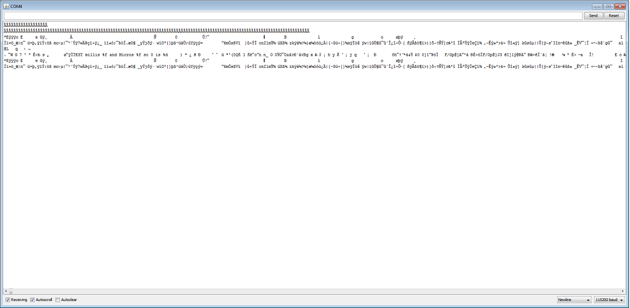

Hello, when i use sprintf and Serial stuff at once, everything getting screwed
When i run this code:
Code: [Select]
char* s;
 sprintf(s,"TEST millis %f and Micros %f so 0 is %d",millis(),micros(),0);
 Serial.println(s);
 s = "";
This output happens (Spam, very fast..  the 1000milliseconds delay will be ignored):
Serial stuff is working without sprintf
Informations:
im using Arduini 1.0.4 IDE
i tested this code on Arduino UNO R2 and on my both  MEGA 2560
A year ago, it worked well (i think it was arduino 1.0 IDE), since 1.0.1 its screwed
And before you think the %f in sprintf causing this problem, i tried to floor/round the millis() and micros() command to use it with %d and/or %i .. no luck
Does anyone have a fix for this?  maybe a working stdio.h?

Code: [Select]
char s[60];  // <<<<<<<<<<<<<<<<<<<<<<<<<<<<<<<<<<<<<<<<
 sprintf(s,"TEST millis %ul and Micros %ul so 0 is %d",millis(),micros(),0);  // <<<<<<<<<<<<<<<<<<<<<<<<<<<<<<<<<<<<<<<<
 Serial.println(s);
You failed to provide an actual buffer.  %f has never worked.  %f never will work when you pass an unsigned long.
