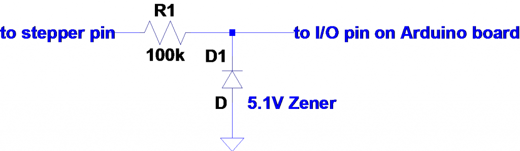

Aha OK without illustration its a little difficult to articulate. What I propose to do is to connect the 4 pins on the EPSON board to the arduino board, so I do not intend to connect the motor. The pulses are sent to those pins and I want to use Arduino to record the number of pulses. Does this make sense?

I've never attempted anything like this, but it seems like you just need some kind of level converter (simple voltage divider maybe?) to get the voltage down to safe levels for the arduino.  Then you could use an interrupt on a digital pin to count the pulses.  Does that sort of motor controller require a certain load to function properly?

I can get my head around stepping down the voltage before I connect it to the Arduino board, but where I am really stuck is whether or not I need to ground something? If so, I really cant imagine how this would work (see images: http://arthurprior.com/index.php/miscellaneous/temp/)

Whatever voltage your stepper runs on has to be referenced against something that we will call ground.  You would connect your micro board ground to this ground.  You need to protect your input pins using something like this:

Why not just read the input pins of the dual H-Bridge on the Scanner PCB ?!?! There is absolutely no need to go this way to count the steps. Also, you know how many steps the motor has per turn, so you can calculate how many steps it takes to move the scanner from one end to another.
