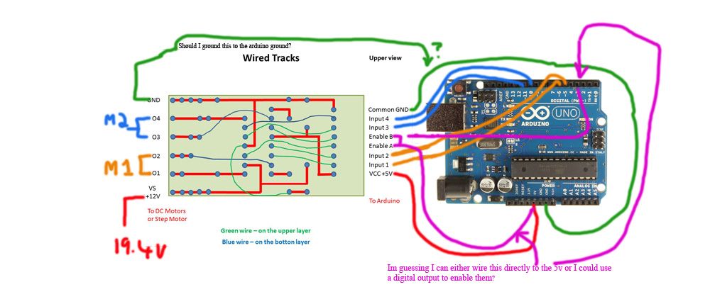

Hi all,
       So today I built myself a l298 motor controller for the purpose of controlling a few 24v dc motors.  I used an instructables paint by number type of tutorial thinking that it we be clear on how to set it up with arduino at the end..but it isnt so clear to me.
Here is the link for the board that I made
http://www.instructables.com/id/Dual-H-Bridge-L298-Breakout-Board-Homemade/
What I would like help with  is how to use it, what pins I should use and which grounds to connect together and also if Im going to have an issue using 0,43 ohm 1 watt resistors instead of the 0,047 it says to use.
Ill be setting it up for pwm control of 2 motors.  I measured the amps of both motors and it seems I am under the 2amp limit of this chip.
my power supply is not quite 24v(19.4) taken from an old laptop that died but it has about 4amps output.
Its really just the hook up that im looking to complete and if those cap and resistor values are within spec..

You have to know the maximum current of the motors, the "stall current". The driver should be able to supply that kind of current. So you might need another driver after all.
Sparkfun has a nice selection, https://www.sparkfun.com/categories/179
The power supply from the laptop is okay. If it is a good brand, a 4A model could supply 6A or 8A, but it will get too hot if you draw more current than the maximum.
Do you want the DC motor to rotate in both directions ?
If so, you use a normal H-bridge.
http://en.wikipedia.org/wiki/H_bridge
The GND (X2-1) and +12V (X1-3) are not used.
The connected on the left has GND and +5V. Those should be connected to the Arduino.
So the Arduino provides the +5V, which is also used by the L298 for the logic signals.
For the sense resistors, see the datasheet of the L298.
The current to the motors via the H-bridge is also going through the sense resistors.
2A and 0.43 ohm = 0.86 Volt. That is okay if they are 2W and  2A is the stall current.
carbon_adam
Erdin the motors are not that big and as I said I measured them and stall was less than 1amp each so I should be fine.  Id rather try and get this working as I have no real money to go off and buy anything..Im not kidding:(

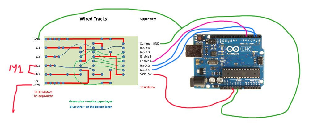

I made a little picture to make it a little clearer of where I want to make sure I'm hooking things up properly.  The image should server as a nice example of how some newbie like me can hook this all up
Normally with a h bridge Id expect that I would have 1 PWM and 1 digital pin to control direction but its seems from this setup that its using 2 PWM outs from the arduino.  I am not sure of what advantage or disadvantage this has (apart that Im using 2 extra PWM on my uno).
Im trying to make a fast Gimbal head that uses a potentiometer as the initial controller for example 0 - 512 :: 512 - 1024 = PWM left and right for each motor 512 being middle or 0 PWM
Anyway just trying to sort out this pin stuff and in the meantime looking fro some nice code to run the PWM..
JimboZA
Quote
Probably easiest to have the inputs not pwm'd, ie just h/l or l/h for direction, and pwm the enable pin (the one you're wondering about putting to 5v or digital pin). That way you only need one pwm pin per motor.
And yes you need to ground the driver board to the Arduino, else the signals which the Arduino "knows" as 5v have no 0v reference at the other end of the wire on the driver board.

carbon_adam
ok so your saying to use a non pwm pin for example input 1 and 2 (lets say pins 1 and 2 from the Arduino for the direction change) say 0 1 for left and 1 0 for right and then use the enable pin with PWM for the speed?
I mean It doesnt bother me too much to leave it as originally intended but if its going to make code easier then that's a plus
Erdin
Yes, I'm also used to connect the PWM to the Enable.
The Arduino uses a PWM of about 490Hz, which the L298 can easily follow that with the Enable.
As far as I know, there is only one exception. There is a driver that can't have a high frequency at the enable, but I forgot which one. Almost everything else uses the PWM at the enable.
You use Arduino pin 1, but pin 0 and 1 are the RX and TX for the communication to the PC (via the USB). Please don't use pin 0 and 1.
I wrote something that was wrong. I wrote: "The GND (X2-1) and +12V (X1-3) are not used", but I ment that those are not used for the motors. They are used for the power supply, but you figured that out already.
