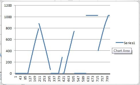

i try this code on my arduino to get ac signal from transformer 50hz. but why i did not have the sinus graph instead square wave i get here
what is wrong with result?

now the result look like this (plot in excel )
. what im try to do is get the sinus graph from the ac supply. how can i do that.

First off that will feed -5V into the arduino which will damage it.
Next as said the peak voltage for a 12V AC signal is not 12V but 12 times 1.4
You can not get what you want with that schematic. You need to apply a 2.5 V bias to the analogue input and then AC couple into it ( use a capacitor), then change that bottom resistor to 3K3.

but i mesured with multimeter it show 5V. i set VR to 14kOhm. the out put to arduino pin is 5V Grumpy_Mike,
Quote
what u mean it by 12 time 1.4? is the output will be 16.8V. it not verry clear to me.
Grumpy_Mike
You are asking questions and then arguing with the answer!
Your meter measures 5V on its AC setting. That is measuring the RMS value of the voltage, it is not the peak nor is it the peak to peak reading. To get the peak reading from the RMS value you multiply it by 1.4, so yes the peak value you get from 12V AC is 16.8V.
You need to look up your basic AC theory.

i see now, so what i measure is not Vp-p value..ok i will modify the circuit and see the result..thank mike  XD

how to make bias to my circuit mike?
Grumpy_Mike
Two resistors of 1K attached to the analogue input. The other ends go to +5V and ground. Then the input sits at 2.5V and your capacitor attaching it to the AC source can pull it up and down from this point.

hi mike, i have modify the circuit.. like this..
tell me if im wrong
Grumpy_Mike
Yes it is wrong the capacitor should be between the two potential dividers.
