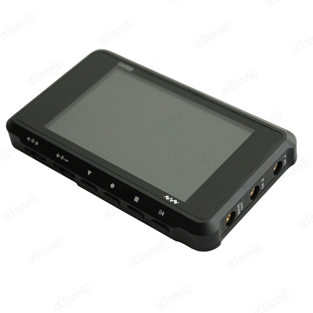

You can pick up a handheld one with 1 or even 4 channel oscilloscope but you're going to lose the resolution you have from the big machines which can handle 100mhz + the cheap $60 USD one from ebay is great if you change the firmware like i did (more optimized open source, faster better options) all for $60! it even has a signal generator which you can specify the frequency...
So the big main difference, pocket digital ones usually handle 1-100mhz (careful, some are in the khz range) but you can carry one in your back pocket and have 4 channels on it for
http://www.ebay.com.au/itm/ARM-DSO-Nano-Pocket-Sized-Digital-Oscilloscope-DSO203-D131z3-/370728363913?pt=AU_B_I_Electrical_Test_Equipment&hash=item565121e789

DSO 203 is a pocket size 4 channel digital oscilloscope for common electronic engineering tasks. It's based on ARM cortex M3 (STM32VCT6), providing 72Mhz analog bandwidth with integrated FPGA and high speed ADC. Internal 2MB USB disk could be used to store waveform, user application and upgrade firmware.
Feature:
3 inch TFT LCD 400x240
Pocket size and light weight
Two 72Mhz analog channels and two digital channels
Signal Generator
Auto Measurement
Elegant metallic look
Various Triggering Option
Easy waveform storage
Firmware upgrade
User applications
Open source
Specification :
Analog channel * 2 : [CH_A] [CH_B];
Digital channel * 2 : [CH_C] [CH_D];
Vertical Scale: 20mV-10V/div (x1 probe);
Vertical solution: 8 bit ;
Input coupling: AC/DC ;
Max input voltage: 80Vpp (x1 probe);
Storage: 4K per channel
Software trigger type: edge, pulse, level (to be added)
Hardware trigger type: edge
Trigger source: CH1/CH2/EXT
Test Signal generater: 10Hz to 1Mhz
Storage: internal 2MB USB disk
Auto measure: Vmax, Vmin, Vpp, Vavr, Vrms, Freq, Period, Pulse, Duty
Cursor measurement: Level, Voltage
Display mode: CH1, CH2, EXT, CH1+CH2, CH1-CH2, CH1*CH2
Sampling mode: real time
Sampling rate: 1kSa/s - 72MSa/S
Power: Li-ion battery
Dimension: 98 * 60 * 14.5
Weight: 80g (without battery)
I've had my el cheapo scopo for a few months now, I've learnt a LOT from it... perhaps with a more expensive i'll learn even more but i'm not in that "stage" yet where i need scopes which needs to examine the ghz range, i'm not working with digital radio or gps or mobile phones, i'm happy with the low end frequency ....
So i guess the real question is, what fits your needs?
