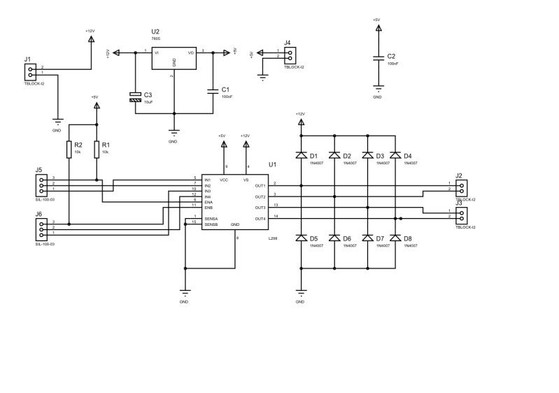

blamski
hhhmmm... sense resistors. i'm not using any...
this is the driver board - http://bloat.me/tfCD. it has motor power in, power out for two motors, IP x 2 and EN for each motor and regulated 5V out. is it this 5V out which i need to connect back to the ground? doesn't seem to make much sense.
here's a schematic for the board too
gbulmer
From my reading of the datasheet, I don't believe it needs sense resistors. But if if they're there, they need to be low enough to conduct all the current through the load (motor) to ground without dropping too much voltage (or constraining current).
The http://www.pyroelectro.com/tutorials/l298_control/schematic.html link has a 10 ohm resistor in that ground path.
I was raising the sense resistor to folks attention because it likely makes matters worse, or more confusing.
HTH
GB
