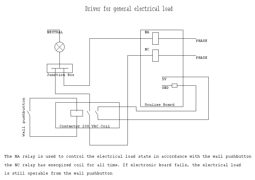

I am new to Arduino and looking for some guidance in regards to doing some automation with the lights in my house. I would like to modify an existing light switch (on 120 VAC) so that I can control in remotely, but I also want the non technical people in my house to use the switch as normal. I don't necessarily want to go wireless for the controls, instead I want the light to report back to a central server (possibly via ethernet) to report it's status.
My thought is to use a three way light switch with a relay on each leg of the circuit and then use a script to control which relay to control based on the position of the physical switch. My dilemma is that I am unsure of the best way for the switch to report back it's position to the Arduino so the script will run properly.
Of course I may be heading down the wrong path entirely and there may be a much easier way.
For example, if the physical switch is in the on position and the light is on, I want to be able to turn it off remotely or with the physical switch and vice versa.

If your light is controller by your Arduino board, you have yet that information. The tip is simply connect the wall switch to your Arduino (as 3.3V or 5V input) an use it to control a relay that will power on or off your light. Of course, if your board can be accessed via Ethernet or other media, you could even give the ON command from another source.
Have a look to this video, it shows the first release of Souliss framework controlling over Android a couple of lights and an air conditioner. At the top of the buttons there is one feedback indication that is red for OFF and green for ON, while controlling the light it will follow the state coming back from Arduino.
http://youtu.be/VuqOFjQTVYg
This release is pretty slow (the actual one has greater performances) but get the feedback directly from the board, without using nothing special, just an Arduino Ethernet and a couple of relays.
The state of the output pin of your board (its values is in your sketch) is the actual state of the light. This will give you a feedback at actuator level, of course if your light bulb is burned, you will not get any advice. If your Arduino is powered OFF you will not be able to power your light, even from the wall switch.
To have your lights in operation also if your Arduino is powered-off, you can use the following schematic, that needs some external components, in this case a relay with coil at 230V and two 12V coils relays for controlling the light.
With this basically your drive the light through Arduino till the NC relay is open, and with the wall switch when the NC is closed. The wall switch position is reported back with an auxiliary dry contact, that became a 5V input for your Arduino.
This solution is used by the developer of the Android application in the previous video, to have full control also in case of failure of the board.
